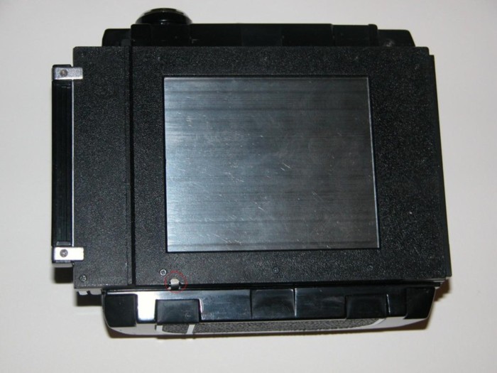

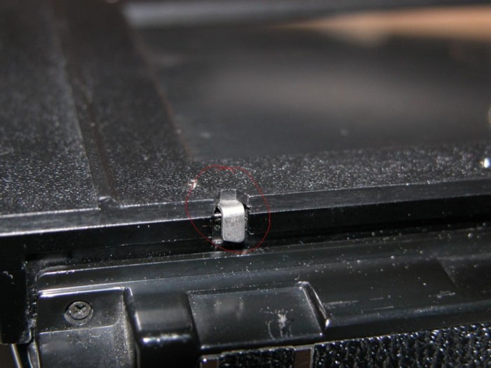

The bummer I have found so far is the ProS film backs. Unlike the ProSD back of which I only have one of, the darkslide does not lock into position when the back is removed from the camera. I have exposed several frames so far by grabbing the back the wrong way from the camera bag, or in my rear pocket. The situation has been remedied by cinching down the slide with a velcro strap when it is out of the camera.
I cannot say enough about this beast. At this moment, neither 35 or 4x5 is even anywhere in my thought process. It is not difficult at all to see why this camera became the standard for professional studio and assignment photographers.
Patrick, on both of my ProS backs the darkslide does lock into place when the back isn't on the camera.

Hmmm... My camera came with one ProSD back. It locks the darkslide quite handy. I have three others, 2 120 & 1 220. They were all bought from Shutterblade, and were in quite good condition except for needing the gummy seals replaced. That was a fairly easy job.
But, none of the three will the darkslide lock into place. The slide itself has notches on both sides midway to accomplish this, but I can find no mechanism in the shell that would engage these notches. They have not been modified, and I just dissasembled one and there never was any place for such a thing to exist. ??????????
The only thing I can think is that they are not ProS backs. Do they say "ProS" on the back itself? I don't mean to sound like a smarta** so please don't take it that way.
Here's a couple of pictures that shows the locking mechanism on my backs. The circled areas are where you can disengage the darkslide.

Must be Pro
Nope. I think that you have hit it. The grip face to the darkslide reads "ProS", but the actual shell does not have the actuator lever shown in your photos. My guess then is that my backs are from an earlier "Pro" series, and simply have the later model darkslides in them because they were from a well used professional lot that the slides got mixed up amongst a bunch of backs.
Solves that riddle, and the velcro strap is still the solution for me!
