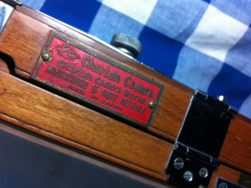

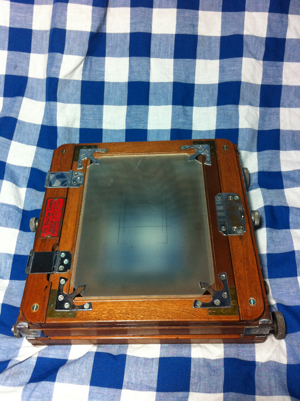

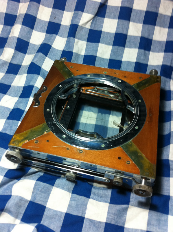

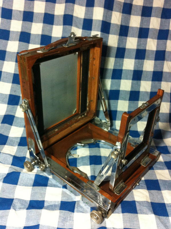

Hi Ian, i've uploaded some photos, not very good quality i'm afraid but i hope it helps.
on the camera itself there's a plate that states charten as a manufacturer (see attachment) but of course that does not prove anything.
i googled asanuma cameras and indeed there are similarities with my camera, and the one from this cameraquest article http://www.cameraquest.com/tanaview.htm also have very similar parts

Looks like it's the Asanuma King, it'll be months before I get hold of my BJPA with the pre WWII advert naming these cameras, but I'm fairly certain F.Charten & Co were the exporters of Asanuma.
