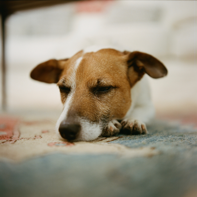

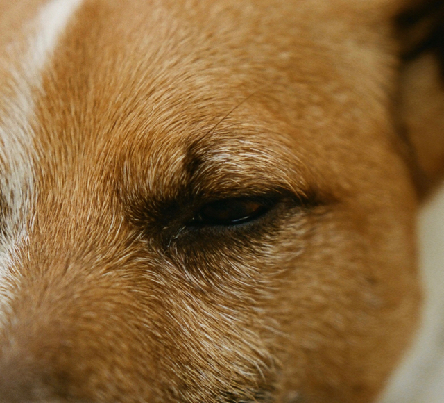

I don't think it was DOF as I got a nice shot w Rolleinar CU lens of my dog -- hair near eyes very sharp --nose soft -- just as I hoped. Here's it is -- reduced to 640X640 for upload. On the full res it very sharp by the eyes, as can be seen on the cropped image
. I think I may be focusing with the center spot and then recomposing and inadvertently changing the camera position as Dan suggests.

With the CU attachment you're working with a very narrow depth of field. When I use mine it's either with a tripod or set on the ground. I also use the smallest aperture possible if I want to get most of the subject in focus. Even at f/22 that can only be a few inches DOF. This will likely require a long exposure. I also use the magnifier almost every time I focus with my Rolleiflex.
