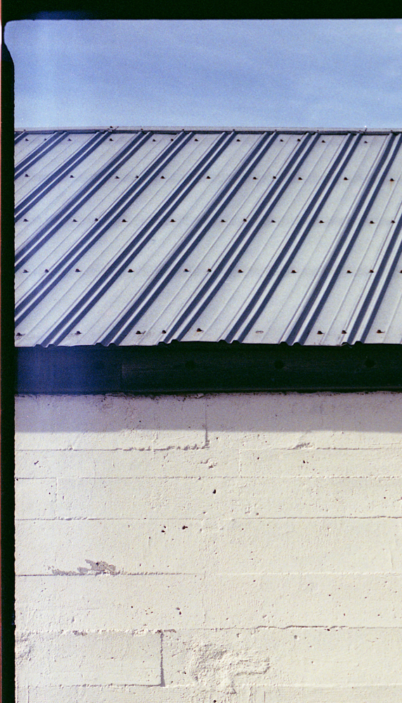

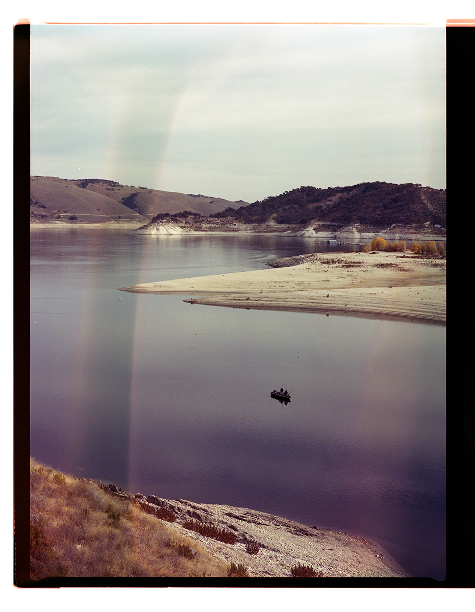

1). Streaks down the neg with density variations (film is Portra 400):

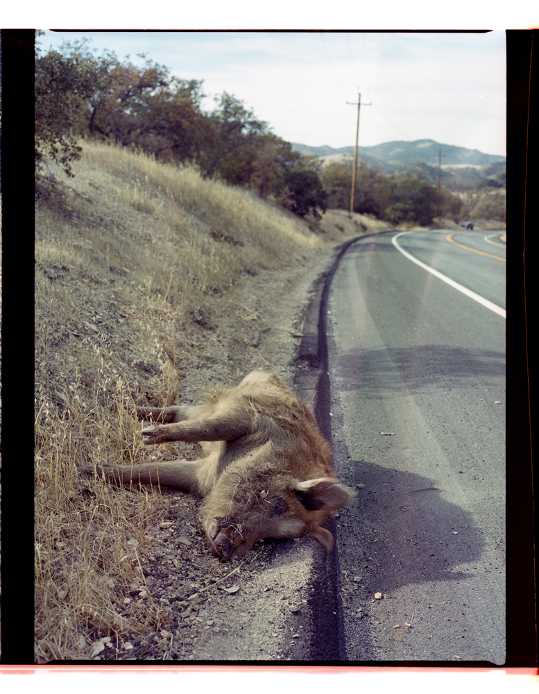

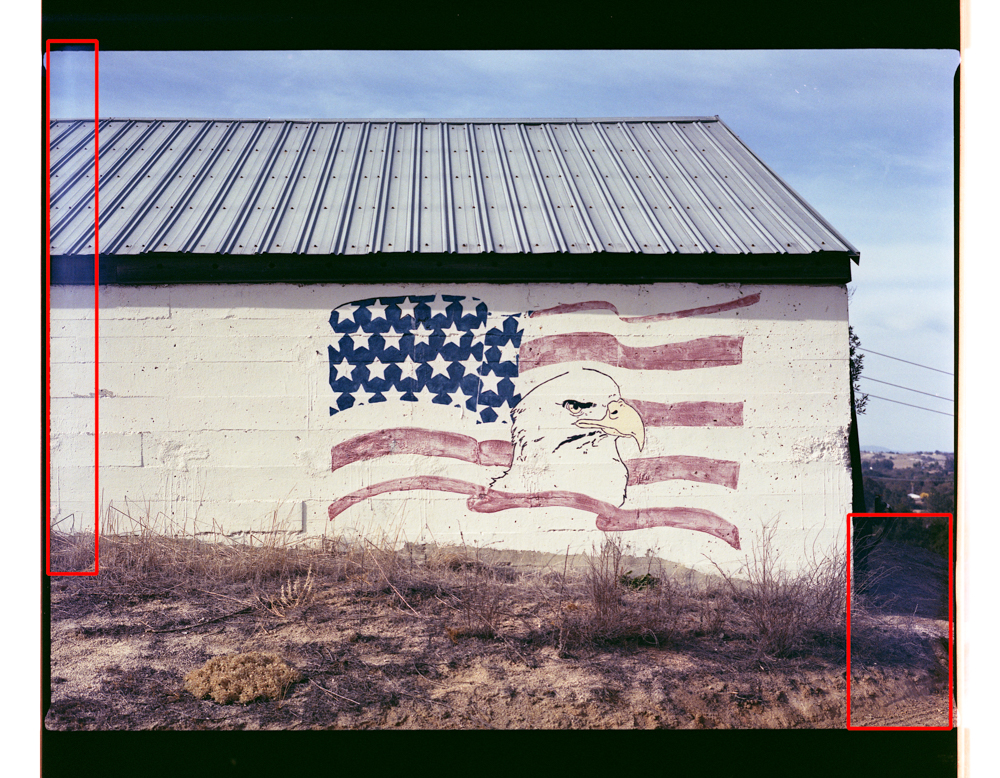

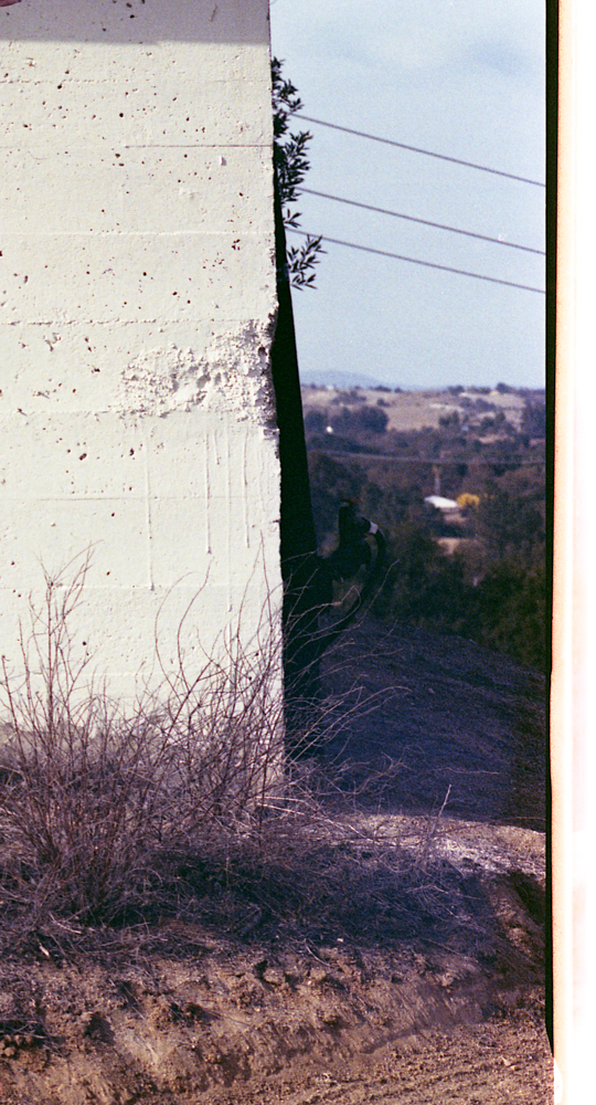

2). Magenta coming in on the top and bottom of the neg (both images rotated 90º in Lightroom after scanning). Appears in both SF and Epson Scan, with neg rotated and moved into different positions. There is no density difference or obvious defect in the area on the neg itself (film is Ektar):

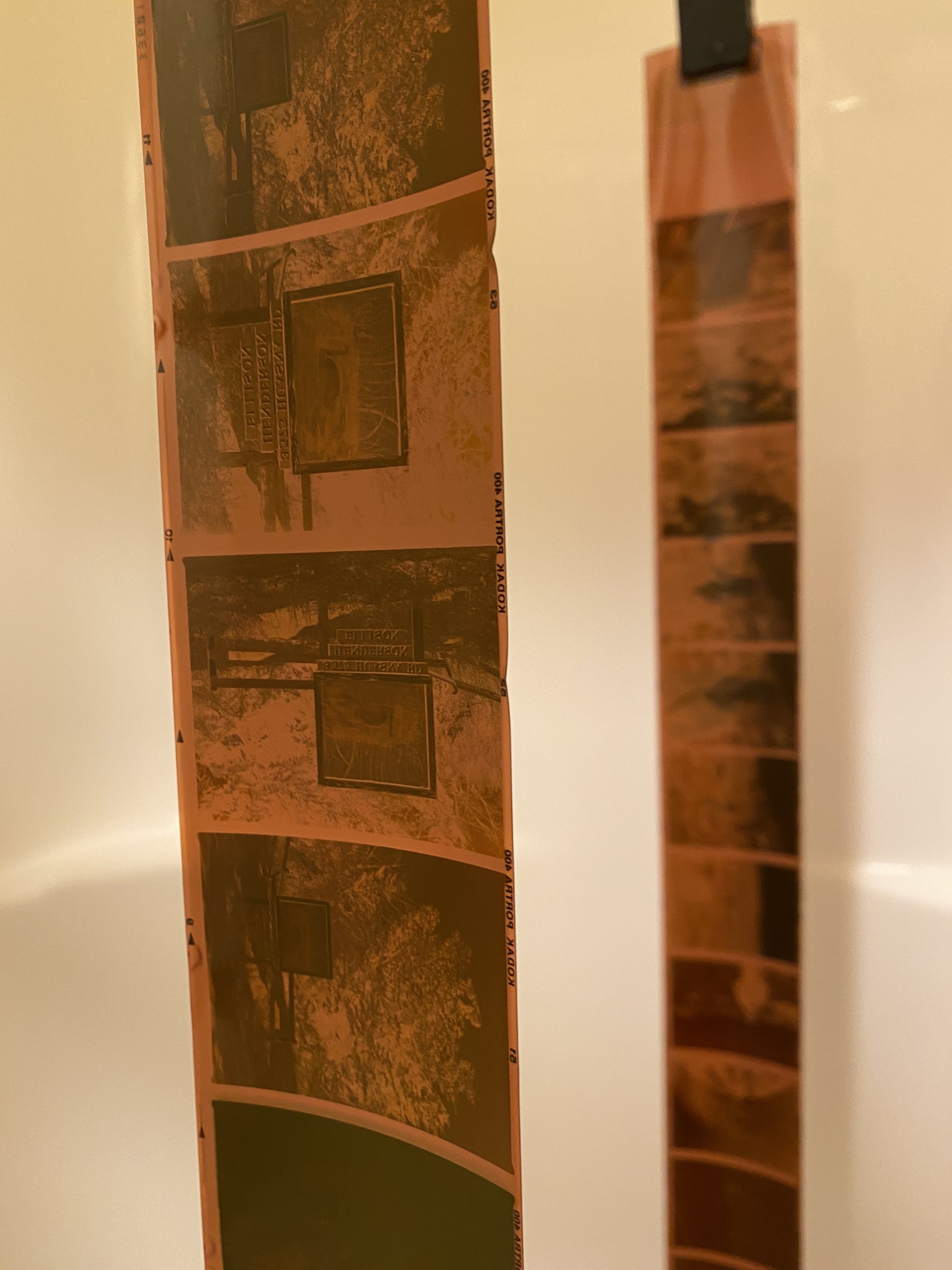

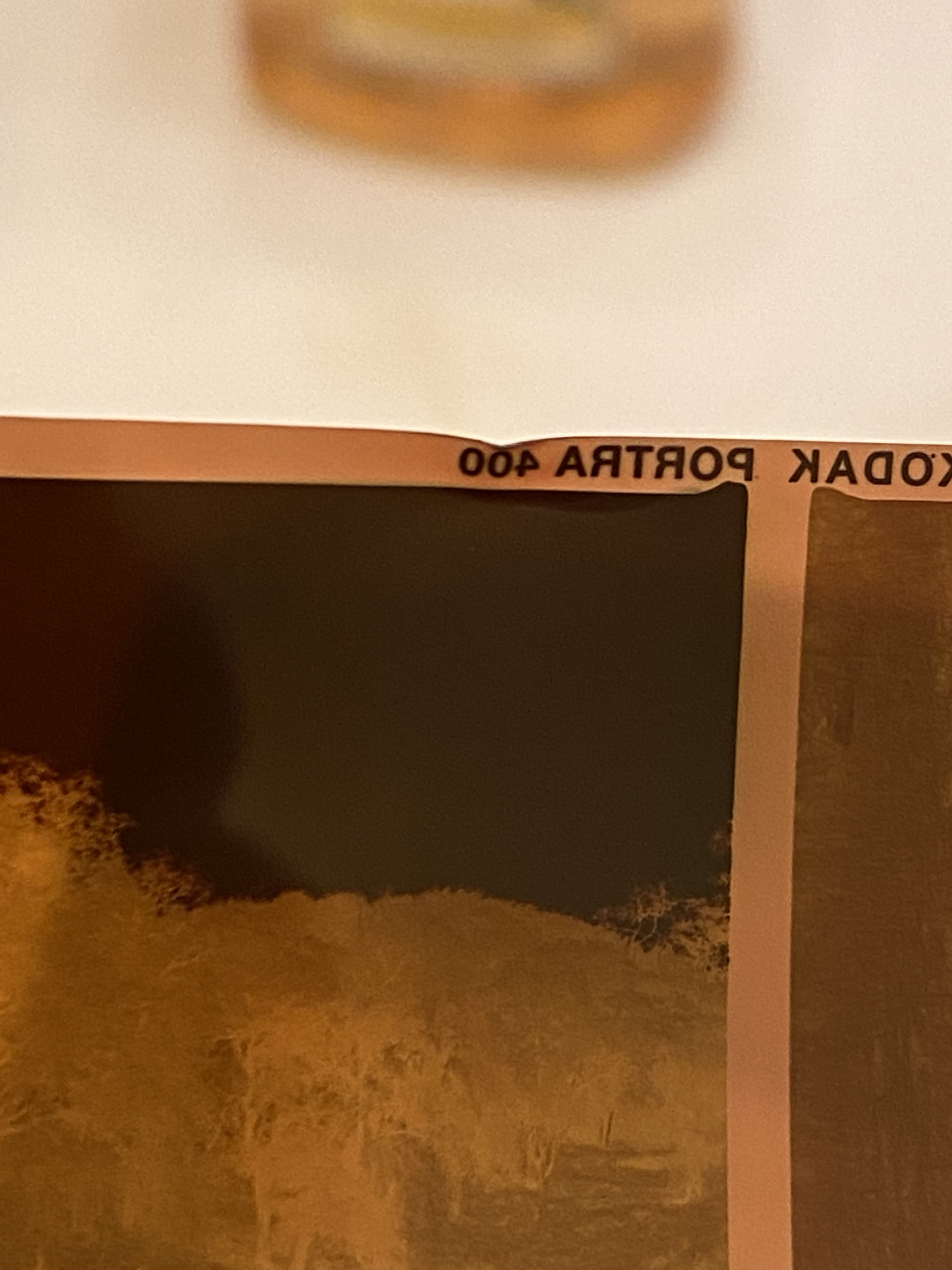

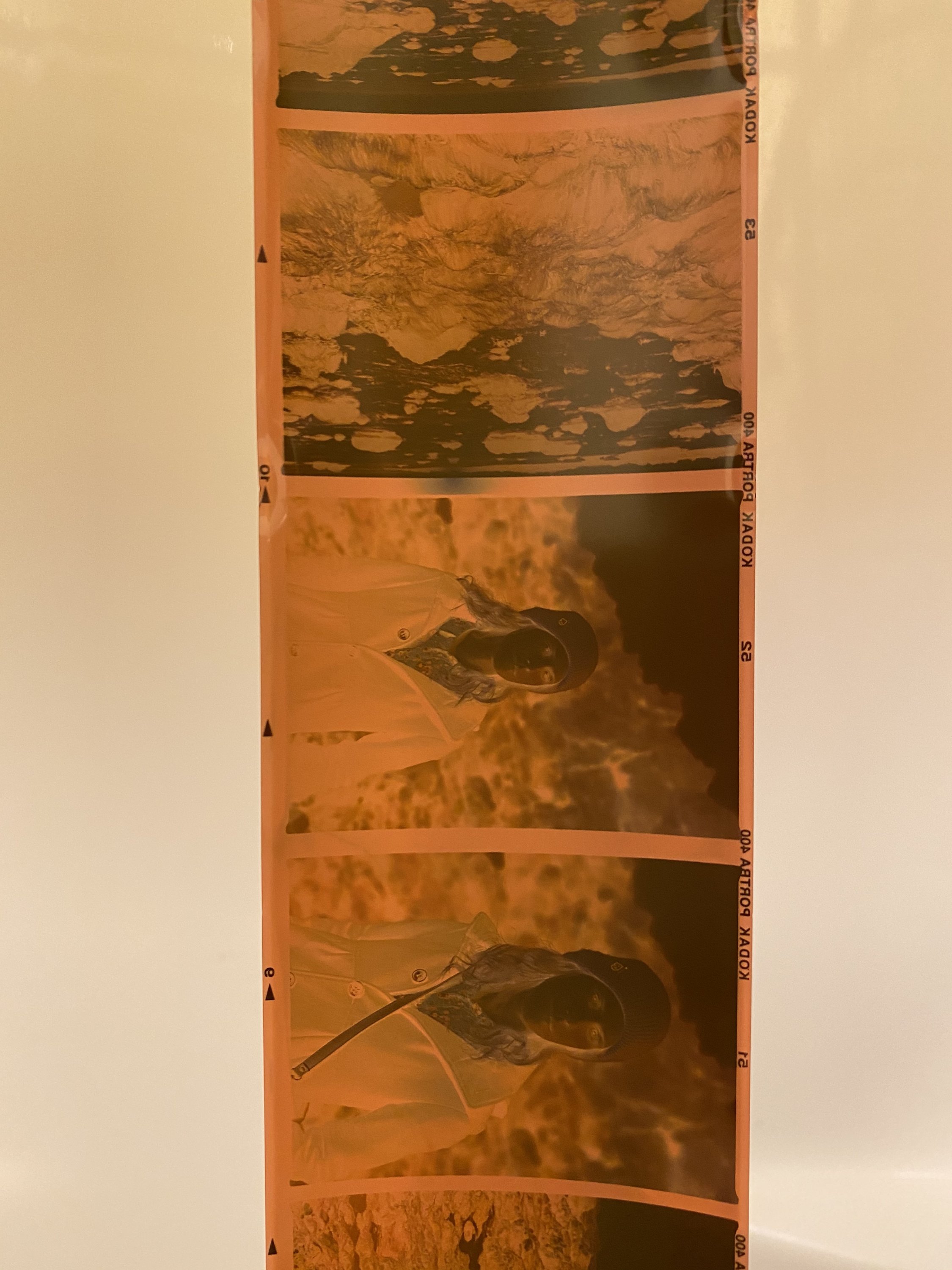

3). Deep dents in the neg - from the stainless steel reel - but not sure how to avoid it or what I may be doing wrong:

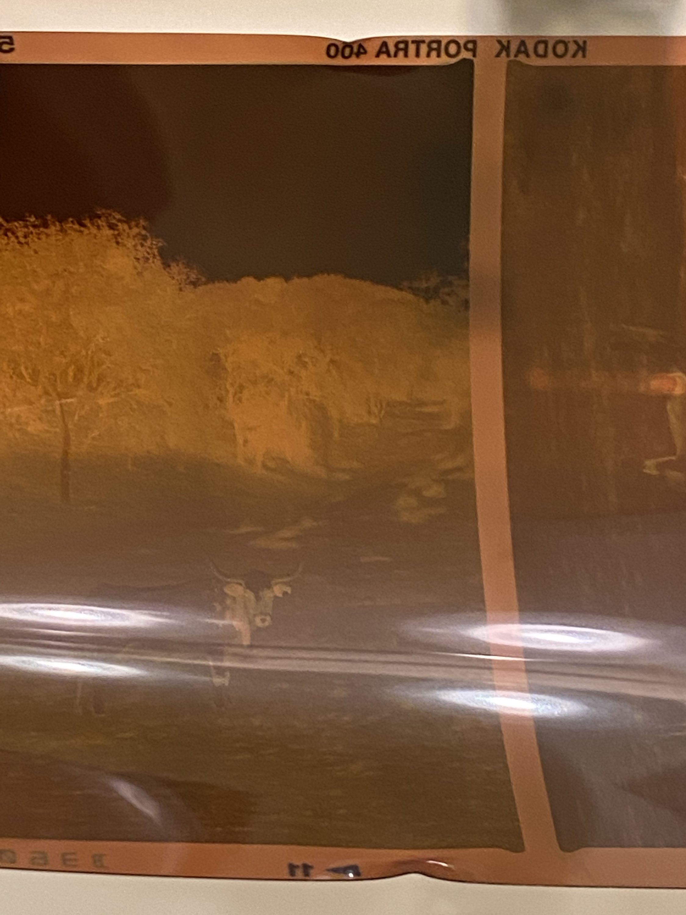

Bright crescent shaped spots on a bunch of negs off two rolls processed at the same time (didn't have this issue the last few times):

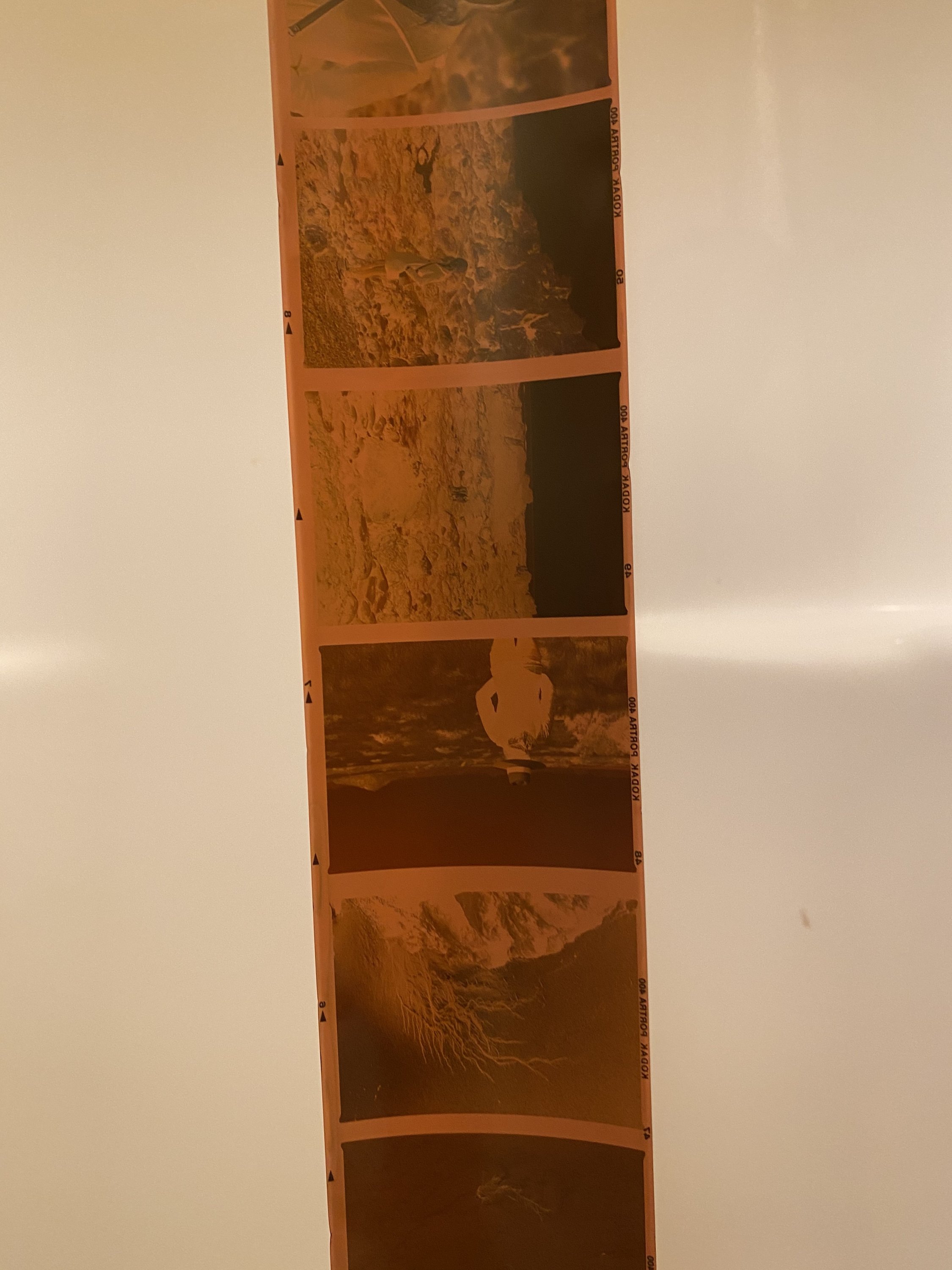

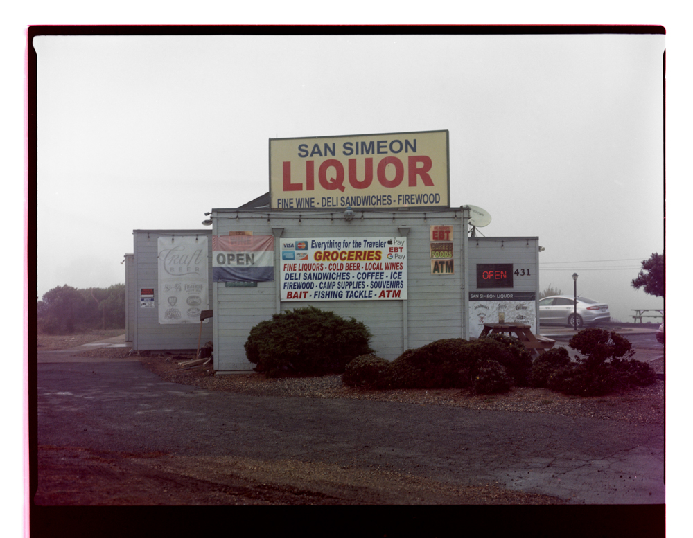

Processed Portra, negs look normal.

One problem is the dents on the edges of the film and the cupping marks on number 10(?). These are related to problems loading the film on the reel. What kind of reels are you using? I had much better success loading 120 on to Hewes stainless steel reels than other steel reels and plastic reels. Also with steel or plastic reels clip the corners of the beginning of the roll before loading the reel. The film should go on smoothly and you should not have any bulges or dents in the film.
You may also have some issues with pouring into and emptying the tank. I will leave that for others to guide you on that issue.

Both the crescent images and the dents are due to the challenges you are having loading the reels.
The solution is "practice" with sacrificial film - first in the light, and later in the dark.
Believe it or not, film will (sooner or later) go smoothly and easily on to those reels, without the pressure damage from pressing too hard (the crescents).

With respect to the magenta at the edges, that could be the result of a bit of light leak due to a loosely rolled 120 film.

One thing I haven't been able to understand is why there are those deep dents on both sides, directly opposite each other. If I had the roll too far to one side or the other and there were only dents on that one side I would understand, but the dents are on both sides. Not sure what it is I should do different. I know when you're loading the reels you can wiggle the film to see if it "slides" a in and out a little and has some give, which I do, which I was always told is a good way to see if the film is loaded correctly. Any tips on that?

Something is causing the edges of the film to bind. Practice loading the reel in the light and then in the dark.

I have a friend who ran a successful photo shop for 40 years. He was a athlete, champion speed skater he could load SS reels faster than I could say boo! He wouldn't fool with the center clip, he would just cup the film and get it started in the first groove. He said that way the film could float a bit and wouldn't get off center.
I would try to practice first. Then start to eliminate things. Change 1 thing at a time. The crinkles are simple, either the reels are screwed up (very unlikely ) or you are not going about it correctly.

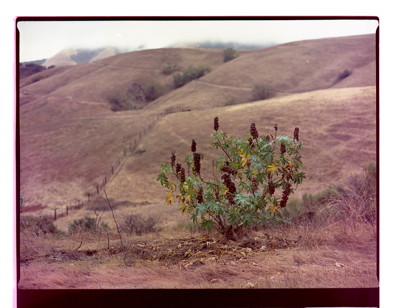

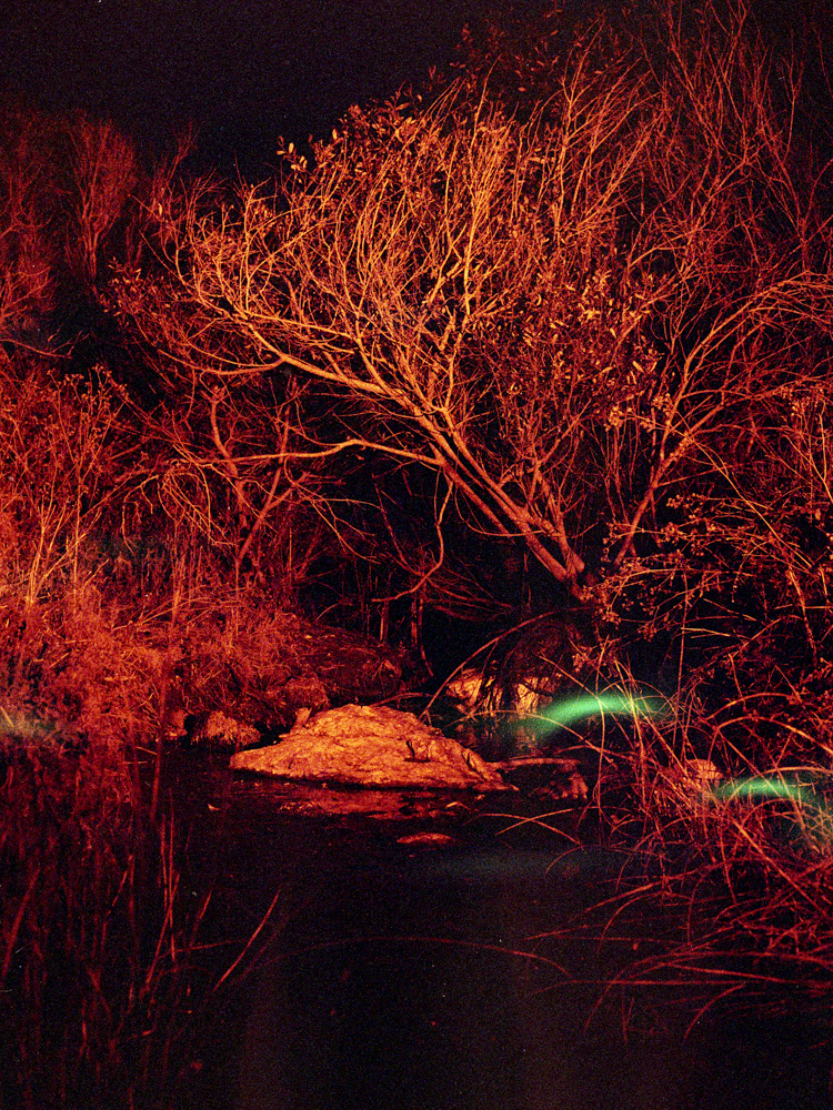

I also have this issue, which I forgot to add to the original message:

Have you used this camera and film and had commercial processing with good results? I've had streaks in sheet film from one way rotary processing. Buy not like this.
These look like chemistry streaks that result from too long pour-in or pour-out times of the developer. Try to keep those as short as possible; preferably below 15 seconds or so.
This looks more like a scanning artifact. Can you see greenish stripes on the negatives themselves in these places?
The dents etc. are due to reel loading issues as the others have pointed out.
These look like most likely light leak issues in the camera or alternatively while loading the film, but more likely in-camera.
There's also a somewhat more remote possibility that they're due to insufficient fixing or blixing, but a light leak seems more plausible.

I don't see any green on the negs where the magenta is showing up, no weird color issues at all. Silverfast always shifts to magenta and red and that's something I always have to deal with, but even when I spun the negs and rescanned them in Epson Scan the magenta showed up in the exact same space so I don't know what the heck it is.
As far as the possible light leaks:
Hi. Yes, until a month ago I sent everything to the lab and have never had any problems at all. I got 3 rolls back from the lab the week I processed these, actually, and there were no anomalies - no light leaks, no weird color issues, etc.
As far as the possible light leaks: I've been shooting this camera, same back, same everything for years and this has only showed up on the rolls I processed myself. The same week I processed my first rolls I got 3 rolls back from the lab and didn't have any issues at all. If it was only one scan or one scanning program I might think it was just that but eliminating variables and still having the issue, haven't eliminated the right one, yet, obviously.
