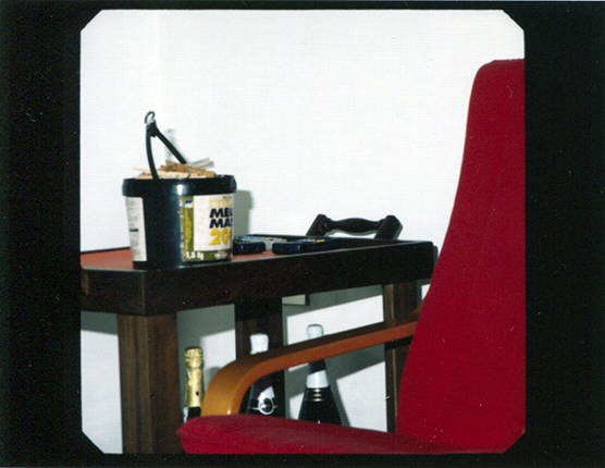

mgb74, I've just tried (6pm circa) and I got this, at f11, 1/125, RZ67 with 250mm (result quite good):
Will try again this evening and let you know.
Thanks
