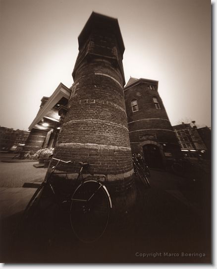

One other tip for printing these negatives: even with proper exposure, you will still have to deal with a huge light fall off during printing. If you want to (partly) compensate for this, I have found the following method of printing very effective. At some point, I became maybe even to good at it, almost eliminating the darkening:
Use a very short hard graded exposure (Grade 3-4.5 for maybe 3-5 seconds) to expose the entire sheet of photographic paper. This hard graded exposure is compulsory, as it helps bring out contrast in the corners of the print. Without it, you will have either black corners, or very flat contrast in the corners, as the negative will be thin anyway in the corners, even with proper exposure during capture of the image.
Next, use a black piece of paper with a hole of maybe 5 cm in it, to illuminate the centre of the image with a normal contrast grade (2-2.5) for maybe 10-15 seconds. Move the paper up and down continuously during this exposure, so as to give the centre of the paper the maximum exposure, and to the sites of the paper less (and preferably none, or almost no additional exposure besides the hard graded at the very edges of the paper).
It will require some practice, but it works nicely to combat some of the light fall off in the prints, while maintaining good overall contrast over the entire print even in the light of the dramatic light fall off and the consequences of that on the negatives contrast across its surface.
By balancing the initial hard graded overall exposure with the exposure with the black paper centre exposure, you can control how much light fall off still appears in the print.
All of the prints in the galleries you have seen used so form of this method.
In this print, the light fall off was almost eliminated:
Much less compensation:
