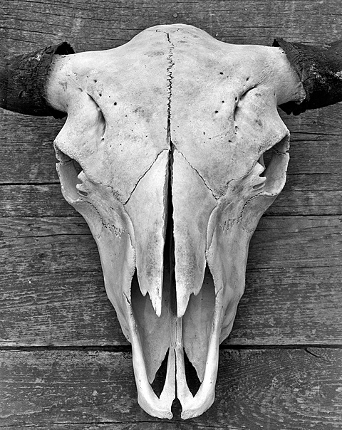

Tony, here's a negative scan developed per above. I tweaked it to resemble the print made on Slavich paper.

Tony, (there was a url link here which no longer exists) is what sold me on the new Kodak Tmax 400. Contrast range on the subject was extreme yet the main body is very flat. Developed in Pyrocat HD with extreme minimal agitation. The negative came out very dense requiring split grade printing.

Unless the monitor is deceiving my eyes that negative sure has some pronounced edge effects?
Sandy
Yeah Sandy, it does. Highly necessary for this very bland rock formation and I cooked it extra hard just for that reason. However, some of this you see may be accentuated by the scanning process.
