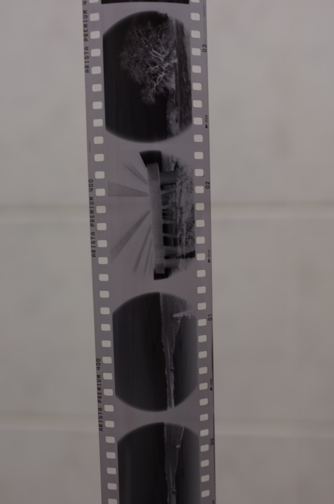

My dad gave me an old soft rubber lens hood. It's the kind that rolls back out of the way when not in use. I was happy to get it because I always thought that was a clever idea!
My FM2n has a 93% viewfinder. I wonder if you can guess where this is heading?? :tongue:
I have almost a whole roll like this hanging to dry:
attachment.php
At the very tip top you can see the edge of a full frame... I changed from my 24mm lens to a 50mm for the last 7 frames ( to shoot for MSA H2O! )
I actually think the film looks kind of cool and will print a few "oval black border" prints, just to see what they look like... there are a couple on there that I was looking forward to seeing so hopefully I can enlarge around this "issue".

So you learned something new; that makes it a good day! I remember learning that lesson about 1978. :smile:. You won't do it again, I assure you!

IMHO, each focal length lens needs it's own hood. That way you get the optimum shading without vignetting. At least that's what I tell my wife when she asks why I have so many lens hoods - just kidding.

Yep, and got a laugh at my own expense as well. It would have been better if I had a photo of my own face as I looked at the negatives and thought, "hey wait something doesn't look quite right!" :smile: Live and learn.

I remember seeing a chart somewhere with all of Nikon's lenses and the recommended hoods. I think it's time for me to find that chart and get this right.

Not long ago I did exactly that. Put Nikon metal lens hoods on all lenses except for the 50 that still has a rubber folfing hood. I don't know why I didn't do that a long time ago.

Many years ago a friend and I both bought a Vivitar 28mm f2.8, (Komine version from the serial no). Mine in FD mount and his in PK mount. At the same time we both bought the same UV filter and collapsible rubber lens hood.
When we compared results a few months later he was getting similar vignetting to the above samples whereas I wasn't.
All depended on whether you fitted the filter or the lenshood to the lens first. He stacked the lenshood outboard of the UV filter and this was enough to give him the 'artistic' effect he claimed he was after :wink:. We're still good friends.

I just looked and I did the same. At this very moment it is stacked outboard of a yellow filter. Fortunately I've been using my F3 and have only shot 2 frames since I changed film in the FM2n, but those 2 will be special too... On my 24mm lens I might get the cool artistic effect either way though, so no problem. :D

The Genuine Canon FD hoods bayonet fit on the outside of the lens so if the hood is the the correct one for that focal length of lens the screw in filter can't vignette the image..

I bet that could actually turn out pretty cool if it hadn't been an unexpected surprise.

I did exactly the same thing before I got a proper hood for my OM 24mm a couple of years ago ... it's that sinking "I really should have thought about that" feeling that I found most painful :smile:
