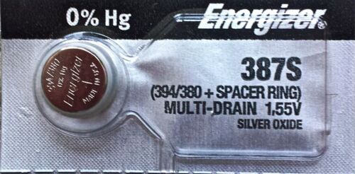

The Wein cells are zinc-ail hearing aid cells. PITA. I have same camera, Energizer 387S is a silver oxide 1.55V cell. I use this in my SP500. THIS COMES WITH A PLASTIC SPACER RING.
Silver oxide batteries last forever, voltage isn't an issue with these original mercury battery Pentax cameras
Wein cells are called for in Nikon FTn metered prisms, not Pentax Spotmatic
