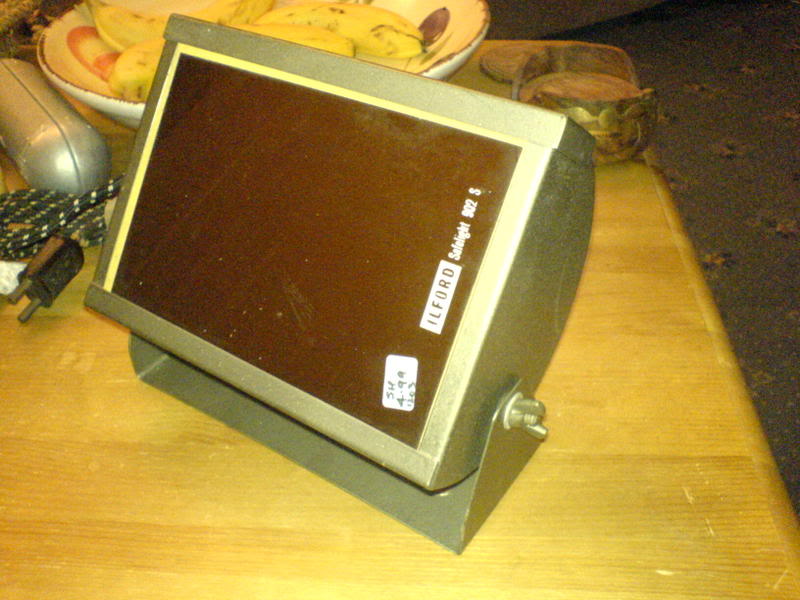

Sorry to hear! I use a 15 watt bulb in the one below...not sure what brand it is though, it is red so that I can use paper that needs red as opposed to the orange, got it $5 at a Craigslist...I keep it >3 feet from enlarger

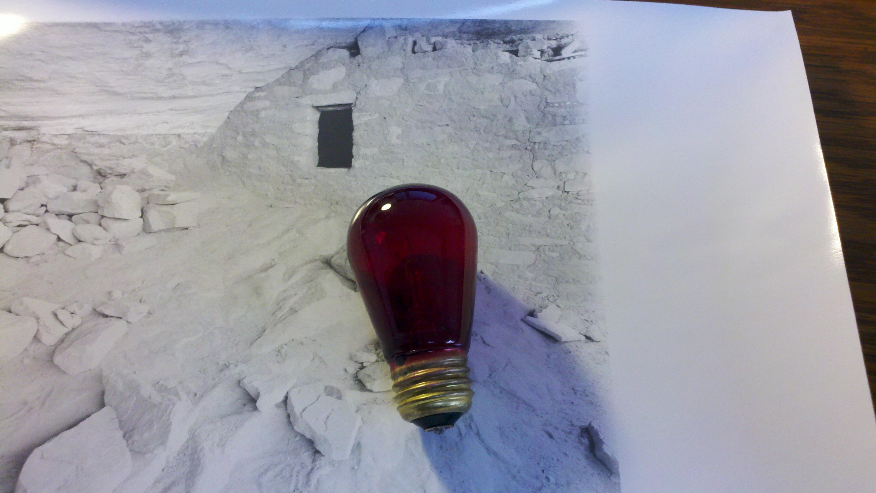

Attached is a print made (albeit bad)from last night. But hey, it's my first DR print in over 2 years!

42556-new-setup-fail-2011-12-04_08-52-22_162.jpg.att
Just put them into a clamp-able/flexible light bulb holder with a built in reflector and bounce the light off of a wall/ceiling interface.

Funny, I did exactly that and hence the picture I was able to accomplish that I posted earlier. But even so, it takes a very, very brief moment of direct light to expose the papers. I'll keep playing with it I 'spose.
