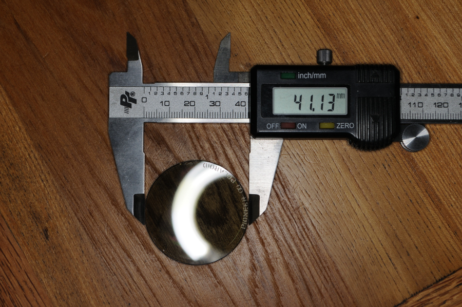

I just measured a series-6 filter as 41 mm diameter, so I suspect that if you remove the glass from a 40.5 mm filter, it would fit. And 40.5 mm is still available new (I just checked Tiffen).
