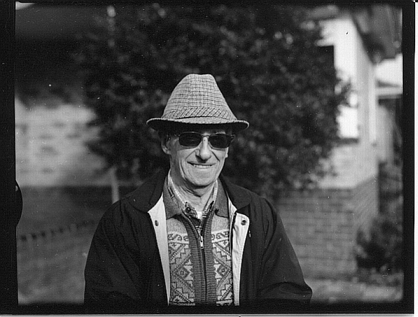

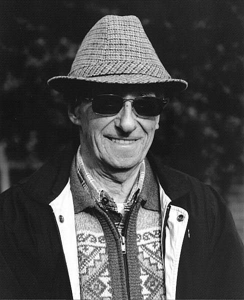

I have included two pictures of my neighbour, who was just leaving for a trip to the shop when I nabbed him. One is a full frame contact print, you may not be able to see this but there is vignetting visible around three sides. This particular shot was an acid test for close focusing, I was about 1.1 metres away, I think the bellows being squashed a bit, may be causing this. It isn't anything I'll be worrying about as I always shoot with a view to print. The fourth side of this sheet (L/H), where there is no vignetting, contains the slight intrusion of the grafmatic film numbering thingy, which on this particular grafmatic, doesn't work, everything else does though and it doesn't leak any light, which is even better.
The second picture is a cropped print of the whole sheet, which I converted to portrait mode. This print was a severe test of my ability to handhold a reasonably heavy camera. It weighs 2.4 kg with a fully loaded grafmatic and a small flash attached, according to the kitchen scales. The fact I was able to get so close, focus on his left cheek outline, trip the shutter and get a quite sharp picture at f8 which is 1/2 a stop from wide open and not really what the lens is designed for, has made me quite enthusiastic about this camera.
