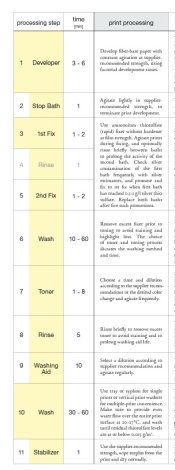

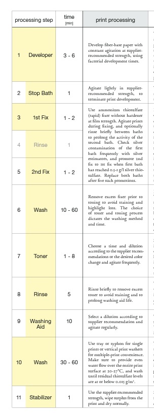

I don't think so. Your development is a bit short. You'll get better Dmax at around 3-4 minutes. Your fixing is too long. Use film-strength fixer, but don't fix above 2 minutes or washing will get impossible. Your washing is way too short.
(see attached for Way Beyond Monochrome recommendations)
