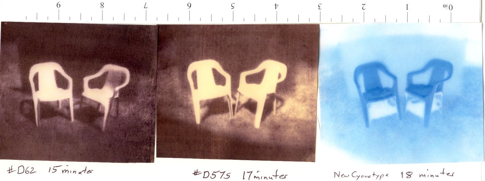

Here are direct photographs of lawn chairs using this positive process and cyanotype. The positive ones used non-starch paper (UniversityProducts Perma/Dur Unbuffered) with added white glue and arrow root (left) and corn starch (center). Right image is with Mike Ware's "new cyanotype" formula on the same paper. They were all taken near mid-day, but not at exactly the same time, so shadow angles vary. There is a black drape behind the chairs in these images. (The image in my original post uses a starch-containing paper - some ancient bond paper before buffering became standard - and a newer larger lens - and a different location and angle and backdrop.)

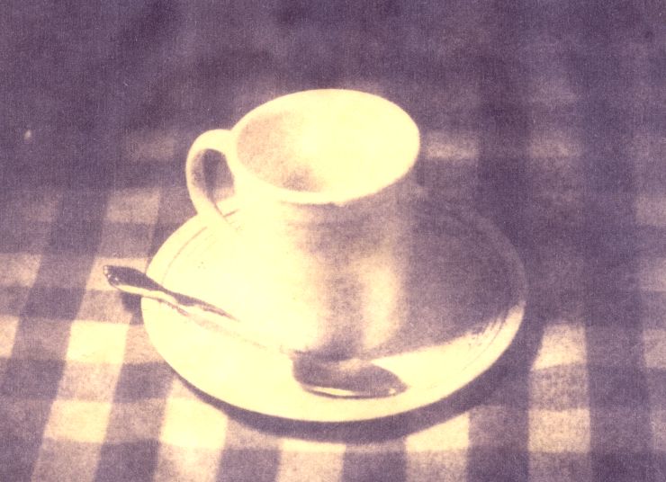

Here's another image, taken indoors with UV (395nm) LED illumination:
The "camera" here consisted of a 3.75 diopter (267mm focal length) 35mm diameter reading-glass lens and a poster-board box. Required 3-hour exposure using a total of about 25 watts of 395nm illumination (65 watts of electrical power input and efficient UV LEDs, EPILeds brand). Contrast is still too high, but I'm out of ideas for improving (reducing) it. I think I'm on to other non-photographic endeavors now, after this summer's obsession with positive siderotype.

Here's a lower exposure, 2 hours, so not as over-exposed. Under-exposed tends to look worse than over, as too little light quickly makes white areas dark (steep response curve at the white end).
