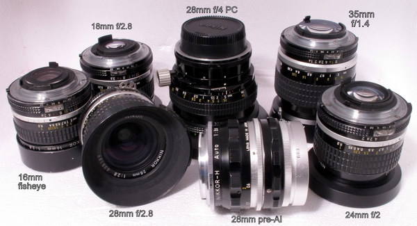

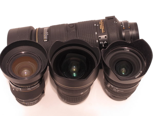

I primarily shoot manual focus prime lenses on my film cameras and auto focus zoom lenses on my digital cameras. However, occasionally I will shoot my Nikon 14-24mm f/2.8 on my F4 and N70 because they do not need the aperture ring like my F2.
When I compared the image quality of my 14-24mm f/2.8 to my 18mm f/3.5 and 24mm f/2 lenses, I was shocked to discover that, at the same f/stop and focal length, my new zoom had better image quality than my older Nikon manual focus prime lenses.
I have no idea how the Nikon 14-24mm f/2.8 compares to newer prime lenses.
http://www.flickr.com/photos/11336821@N00/6179456359/
http://www.flickr.com/photos/11336821@N00/5224724863/
