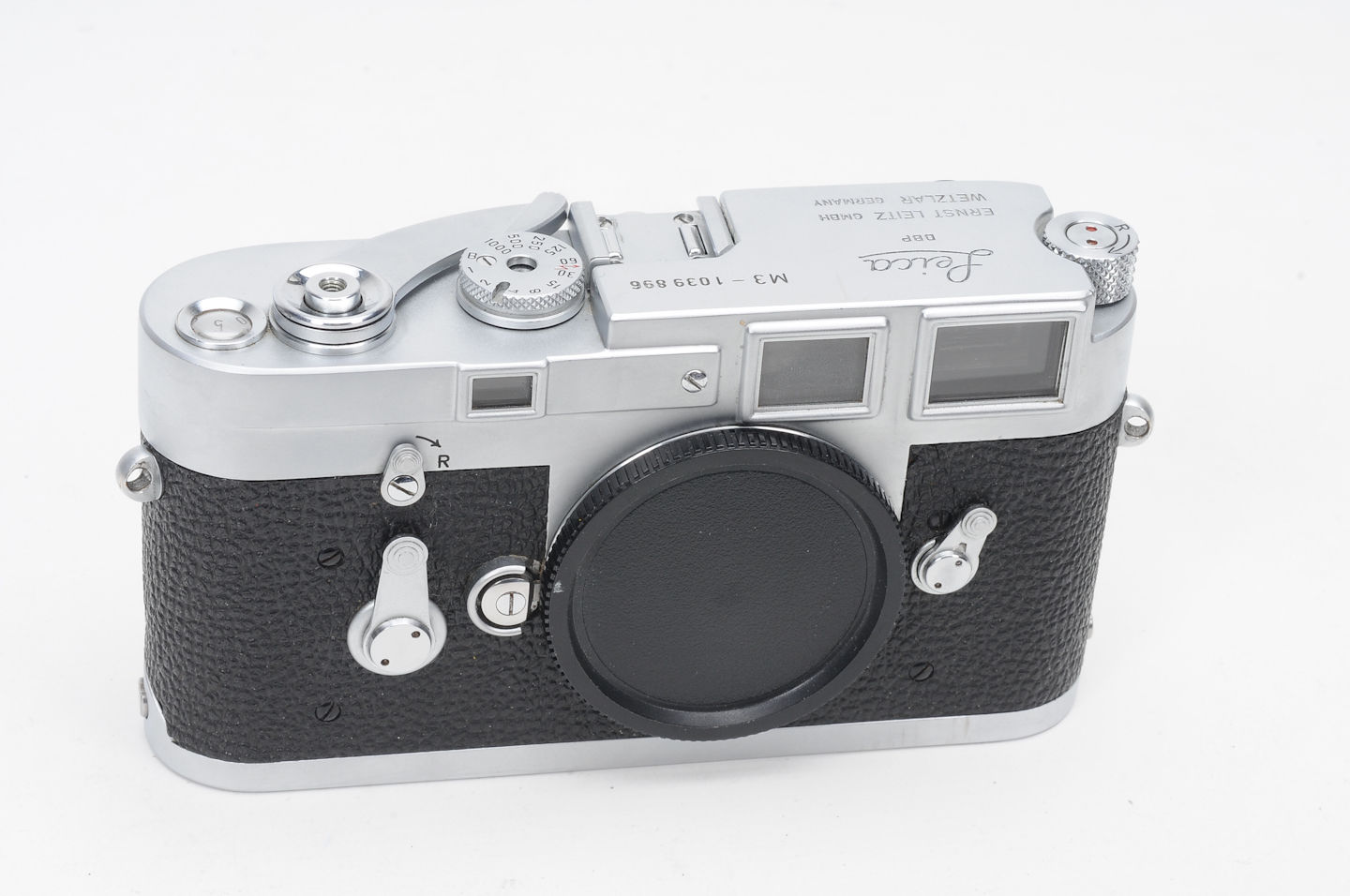

I decided to round out my Leica M family with a SS M3. I've read such good things about the viewfinder/rangefinder of this model I figured time to get one. I'll send it to Youxin Ye for a little CLA and it should be good to go...made 1961.
