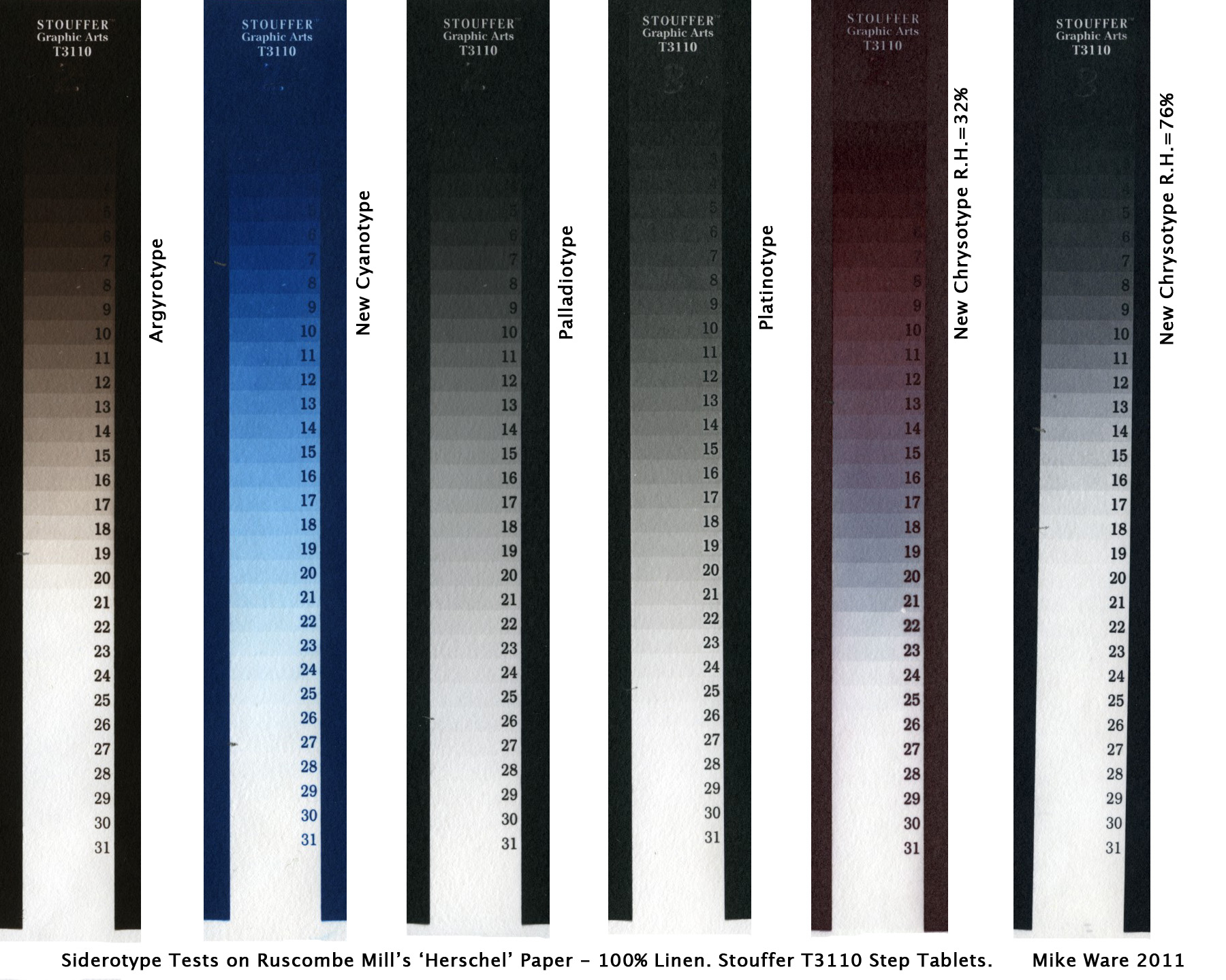

I've tested Herschel paper with argyrotype, new cyanotype, palladiotype, platinotype and new chrysotype (see first attachment). It performs superbly with all these processes as I practice them - better even than Buxton paper in some respects, although it will cost no more.
