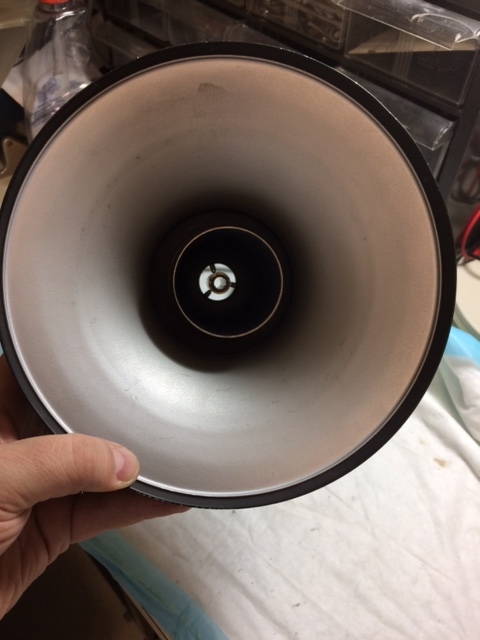

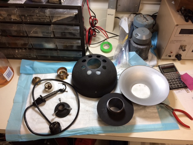

I did try just placing a V54 cold light head with a large diffuser over the condenser and just using the same IC head. The V54 wiring had to come out the side of the housing where the head sits in the condenser housing causing large light leaks. Blocking the leaking light with a black cloth skirt rig around the head was doable but a PITA. The printing was as expected from cold light diffusion.
This led me to purchase an additional head for my 1C for 20 bucks with the intention of fitted the V54 so that all the wires would be coming out the top where the sliding socket pole would be. The head can be dismantled and repurposed with ease but alas I never followed through.
