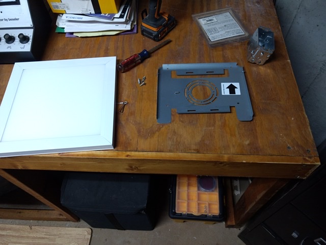

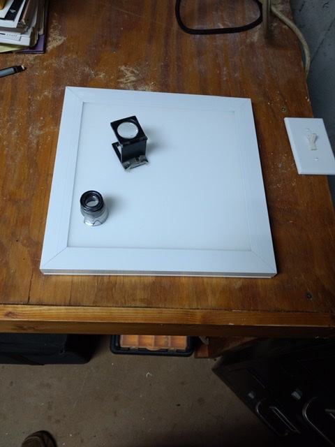

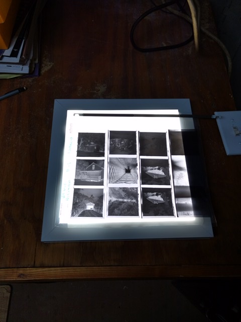

I just got through installing a new light table in my darkroom, from Home Depot!
https://www.homedepot.com/p/Commerc...-Color-Changing-CCT-FP1X1-4WY-WH-HD/304258319
Its a surface mount fixture so all I had to cut out of the work table was a hole for wiring and a cutout for the light switch. Wiring was simple, running the black wire through the switch and wire nuts on the rest. You need to use a grounded cord, I sacrificed an old power strip to get mine.
