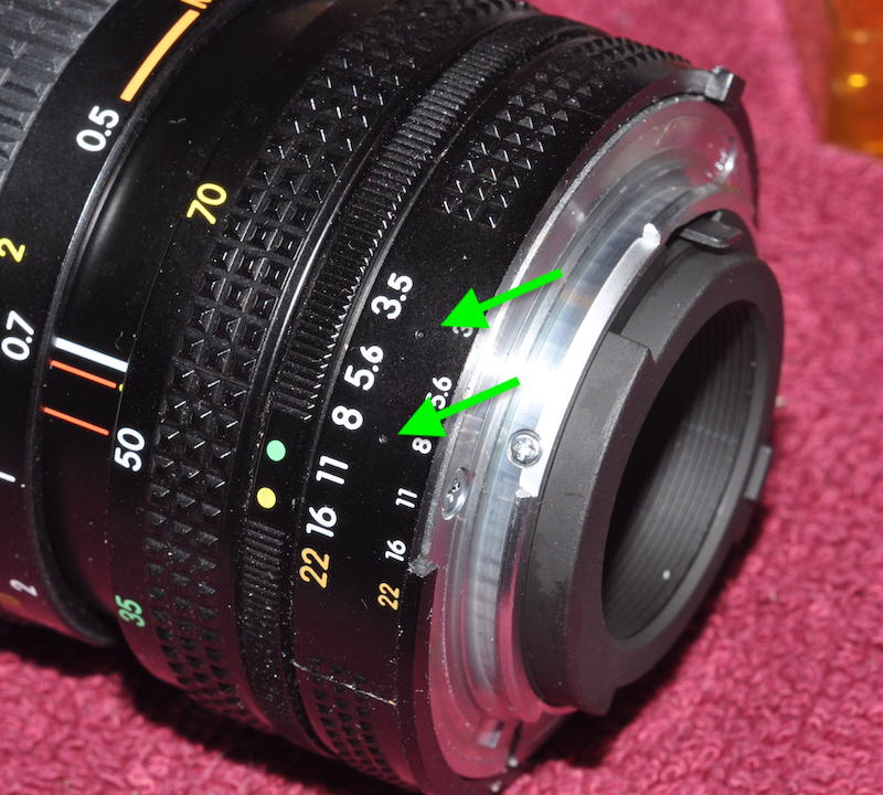

As many of you know there are already dimples to mark where the screws holes need to be on many lenses.

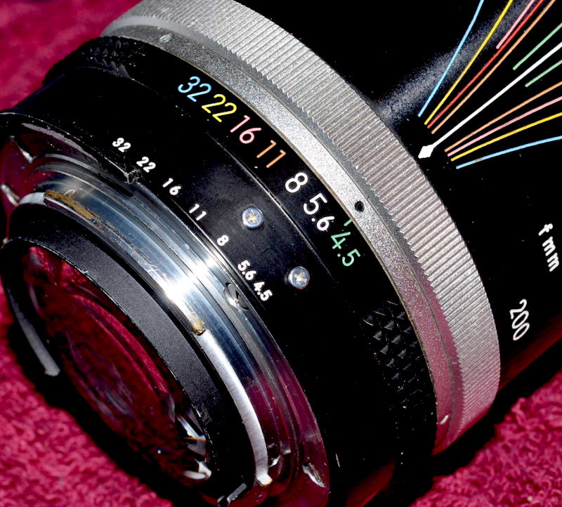

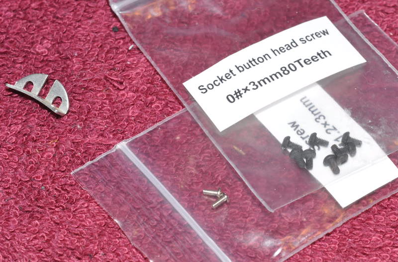

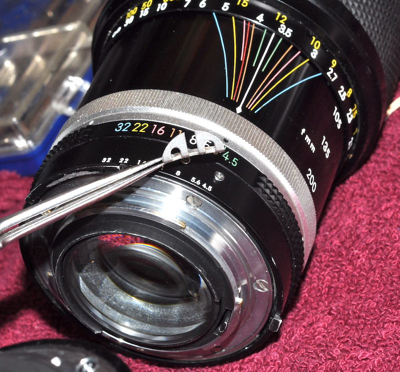

The meter prongs (so called 'Rabbit Ears') can be obtained on e-bay, but I have a foggy zoom (after cleaning) that will be the donor.
The original screw size is larger than M1.2 but smaller than M1.5. So, maybe 'good luck' trying to find an appropriate tap.
Of course the 'Cosina' lens is plastic. I'll make the threads with the screws.

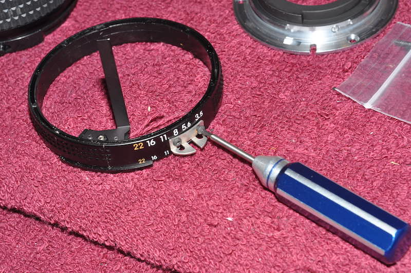

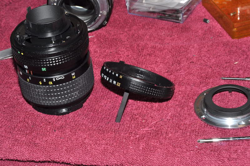

The 'Cosina' lens comes apart just like most Nikkor lenses. After removing the lens mount (the three screws are in plastic so be careful putting it back), the aperture ring comes off.

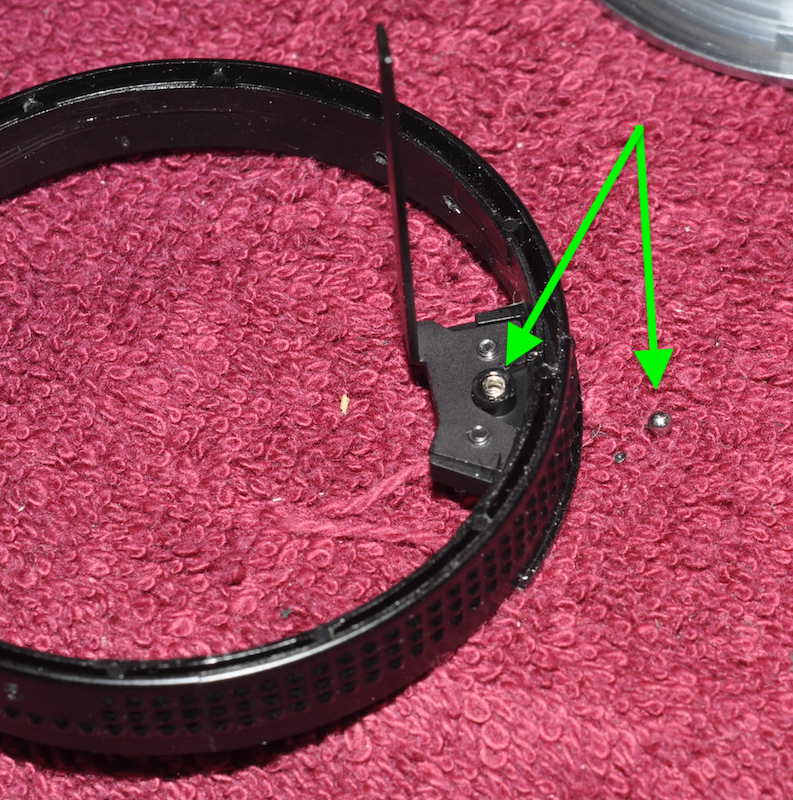

Don't lose the ball bearing for the click-stop!

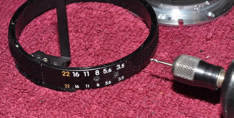

Drill the holes, using the dimples as a guide. I used a Dremel, but it might be safer to use the drill bit on a pin-vice and do it by hand.

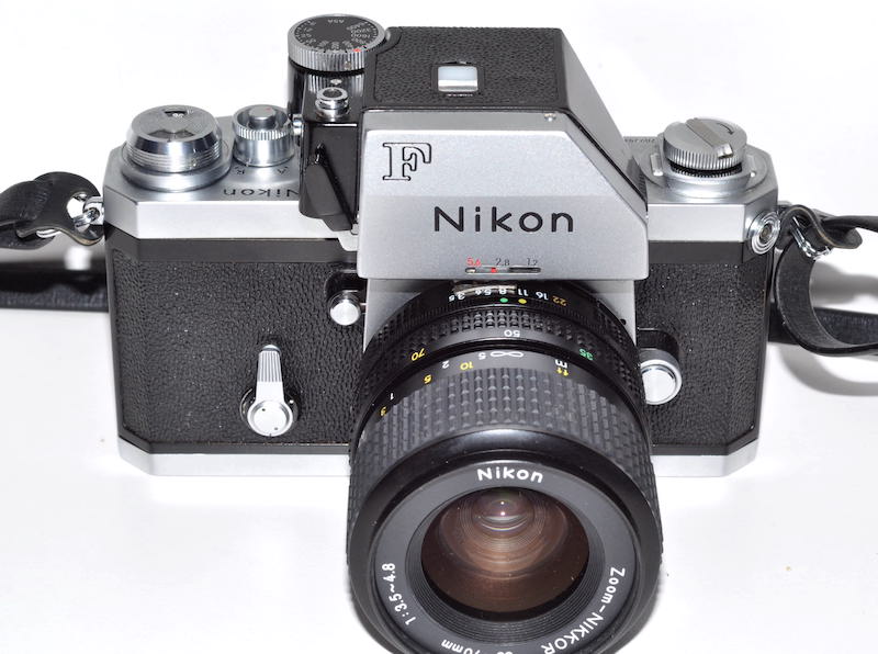

Coupling correctly with the FTn finder of my Nikon F for open-aperture metering!

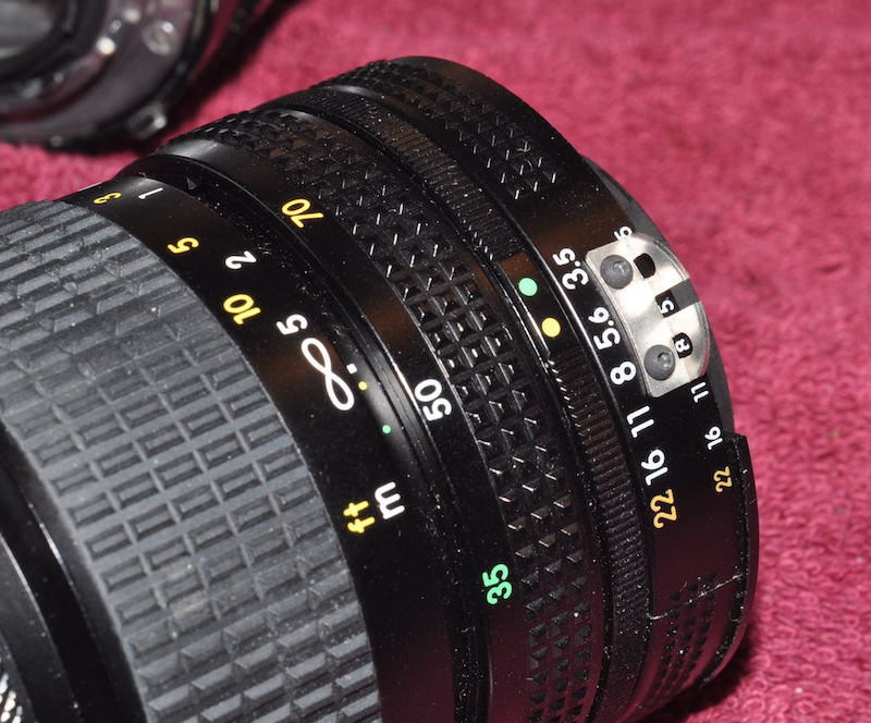

The prongs do make the "Direct Reading Aperture" scale of the AI cameras harder to read, but as mentioned earlier, I have more that one of these plastic zooms, so no big deal there. Anyway, the FM-10 (from which the lens came) doesn't show the aperture in the finder.
Here it is, correctly coupled, showing 3.5 on the maximum aperture index scale.
BTW: When doing stop-down metering, make sure the index is on the 5.6 by pushing the tab up into the housing until it clicks in place at 5.6. Everyone knew this back in 1971, but maybe some folks here weren't born yet 😜
The variable aperture of this lens is not a problem for the FTn finder, but when doing flash photography or any other non-TTL metering, the change in aperture needs to be recognized.
