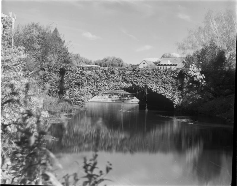

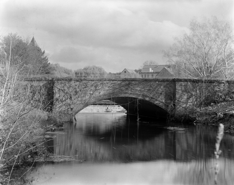

Here is what a Plantograph lens can do for you ! Mine is a Bausch & Lomb 4x5 lens F-8 E.F.6-1/4" I would sell all my other old lens before I sell this one ! the faded line above the bridge rail is a car or cars drive over the bridge :

Thanks for those example shots seawolf!
