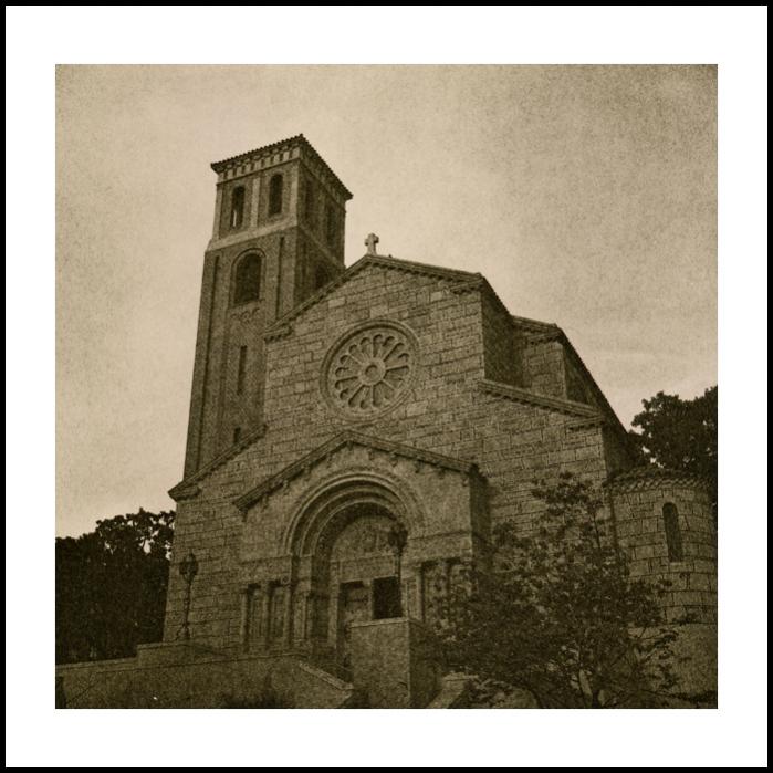

New Kentona Lith
This is a one year old lith print using Fotospeed LD20 and the 'new' Kentona. It works just fine, but there seems to be a narrow sweet spot where color is intense and grain is fine.
I didn't quite hit it with this but think the grain suits the subject matter.
I like it, but have standardized on papers so I don't buy Kentona anymore.

Thanks, Thomas. Is the Kentona as glossy as Fomatone? I found Fomatone to be very glossy for FB paper and I would like something a little more matte, though not fully matte.
Jan 21, 2003
15,715
Switzerland
Nope, not nearly as glossy. But a very beautiful texture with lots of 'depth'. It's as if the emulsion is sunk deep into the paper. A very pleasing look.
