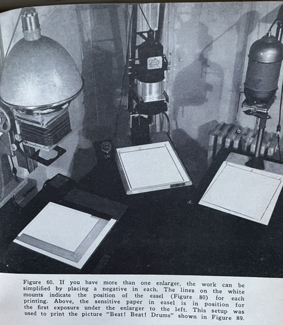

Combination printing? I would setup multiple enlargers. Where? That’s another question in my small darkroom it would be a challenge. I have four enlargers already, and my buddy Jim wants to give me his Beseler 23CII, so I may have five soon. But my darkroom is too small. I told him I would find a good home for it.

Lootens, in the book “on Photographic Enlarging and Print Quality” 1944 shows a three enlarger setup and the print he made from it. A good reference book that will be easy to find. I have an extra copy if you want it.
