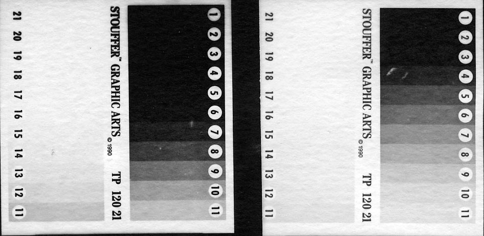

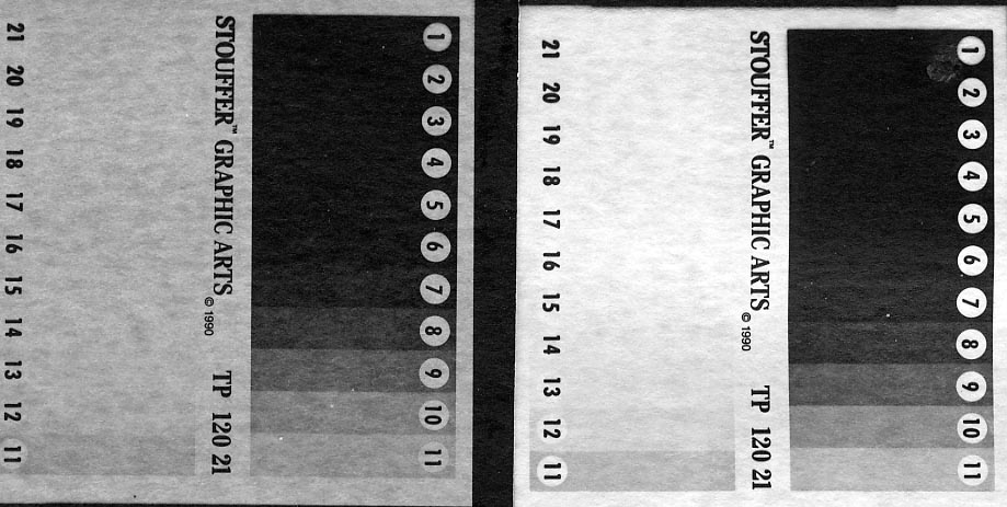

To further this discussion about gelatin, first off in the OP I mention the remarks about gelatin. Well, in the section on ripening the authors refer to using an inert gelatin to make the emulsion and an active gelatin to finsih the emulsion after washing. They give no details, but Kodak engineers and Agfa engineers among others knew of at least 3 if not 4 types of active gelatins. So the subject was quite well known at the time.
Now, to move to modern times we see somewhat the same thing. I have been buying brand "A" inactive oxidized gelatin and recently changed to brand "B" inactive oxidized gelatin. I observed a 1.5 stop speed loss in my Azo type emulsion!
This indicated to me that there is a change in the emulsion introduced by some ingredient in the gelatin so I heated up emulsion A and B and then coated immediately. I also coated at 2 hours and 8 hours with constant heating at 40 deg C applied for all of this time.
The results are in the photos attached.
The surface defects you see are artifacts due to being coated on unsubbed paper. The sample photo on the left shows gelatin A and B side by side fresh, and the sample photo on the right shows gelatin A and B side by side after 8 hours holding in the sink. It is evident that sample B did not change in fog substantially but did gain a bit in speed and/or contrast over 8 hours. This indicates 2 things to me.
One is that gelatin A has a weak ripening agent in it and is not truly a pure oxidized photograde gelatin as we know it today. It is a weak ripening gelatin as was known 50 years or so ago. It causes fog as well as increased speed.
Second is that gelatin B has no ripening agent.
Finally, the emulsion B, through the small change it undergoes, tells me that I need more stabilzer or a longer ripening time during the original make (or both).
Since my coating sessions rarely last more than 2 hours, I saw little or no change with respect to hold time from either A or B in normal coating sessions, but I did see the unexplained speed difference in fresh coatings, and this long keeping test revealed the reasons for the speed difference.
Gelatin B is Kodak photograde gelatin and is sold by the Photographers Formulary. IDK who else sells this, but I have verified it with them.
They change to Gelatin B, when I began to have hints of problems last year with Gelatin A. Gelatin A is still a good quality product, it is just different. And so, to make an emulsion using the methods of James and Higgins, one might precipitate an emulsion with gelatin B (Kodak) and then add A to make up to final coating weight and hold for 1 hour or more at 40 - 60 degrees C as described in the text.
This will conclude my tests, as it is much preferred to use a gelatin of type B (Kodak) and add the precise amount of sulfur containing agent rather than rely on a gelatin to supply it, as the amount of sensitizer might vary too much and would take extensive tests to qualify a gelatin of type A to be useful.

A question about your statement: "The surface defects you see are artifacts due to being coated on unsubbed paper." The only commercially available 'subbed' paper I'm aware of is the glossy baryta that The Formulary sells. Is there another? Or, are you normally subbing watercolor paper before you coat?
Which paper are your tests printed on? If it is cold press Strathmore, you might consider changing to something smoother or giving your coating bar a bit more of a gap. I know you like the heavier paper because it dries flatter, but I think you'd have better luck judging the density range on a smoother paper. Fabriano Artistico HP works well. And for the purpose of jpeg illustrations, the PF baryta might be best.

This is a Strathmore hot press paper. The defects are not visible to the naked eye as such. Rather, the paper has a pleasing tapestry like look and feel. The scanner magnfies this. You have seen some samples like this at the workshop and the above ones look no different (fresh) in the dmin area.
