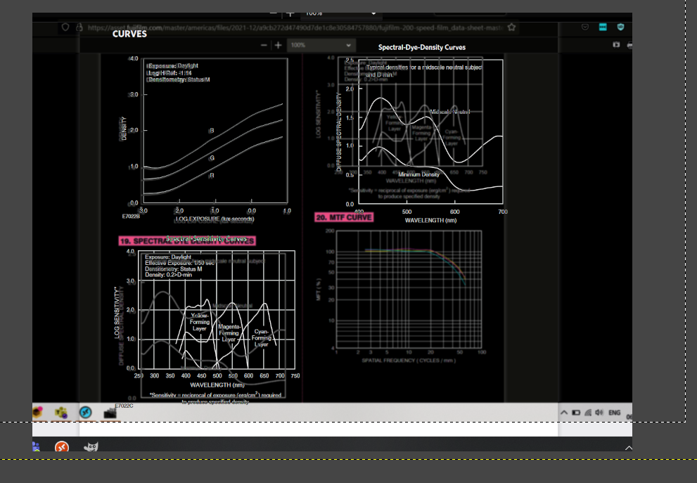

Some people think it's rebranded Kodak Gold 200.
I think u/samdharmawan is correct, rather interestingly this appears to be rebranded Kodak Gold 200. Here's the latest datasheet for Gold 200. Comparing the characteristic curves for Gold 200 and the new Fuji 200, the blue curve has the exact same bump at -3 log exposure, as well as the slight tapering for all three layers at 0.0 LogE, whereas the old C200 stayed straight, as well as all three curves staying pretty much parallel thru the plot. In addition, rather a rather telling note is that the new datasheet uses the terminology 'Cyan/Magenta/Yellow Forming Layer" in the spectral sensitivity curves, exactly the same as Kodak, while usually Fujifilm prefers to use the terminology 'Red/blue/green sensitive layer', as can be seen on the old C200 datasheet. Once this new film starts making it to stores, it should be easy to check the barcodes/COO and see where the film is made.

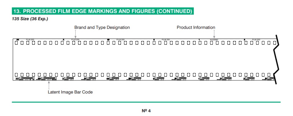

Here is the Fuji data sheet
https://asset.fujifilm.com/master/a...fujifilm-200-speed-film_data-sheet-master.pdf
Here are the edge markings from that data sheet

Edge signing can be changed at production by just pressing buttons.

All the data on pg.6 of the data sheet matches Kodak's rather than Fuji's house style - and possibly the first appearance in recent years of an MTF for Gold 200... Which would suggest that Kodak may be supplying bulk rolls for Fuji US to convert - Kodak aren't hitting the limits of B-38's coating capacity, however their conversion capacity is where the bottleneck is. It may be that with the stoppages etc that Fuji's coating plant has been through, there has been a major shortfall of the consumer 200 speed film that would be converted in the US plant.

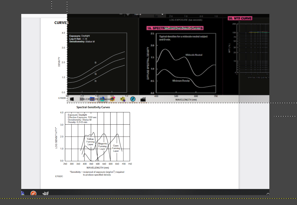

I did a difference of a few curves between gold 200 and fujicolor 200. The graphs are in different order so had to align each 1 individually.
Spectral dye sensitivity curve:
Exposure v Density
Spectral Sensitivity Curves
UP to a point. the marking these days is done with software, and yes, changing the text in each field is easy, changing the layout of the fields takes more work. we have seen recently done products sold by one firm which were converted by another.

If you look at the differences between the Fujicolor and gold datasheet curves I did above, they are identical. It's a copy and paste. Not only are the curves the same, so is the wording.
Overlay the curves from the Fujicolor over the gold and you'll see. The former needs to be enlarged to match the scale.
I thought it'd be a c200 rebranding but after comparing the datasheets, it's gold 200.

Maybe I am not seeing something, but it's the same film - just rebranded. Compare two datasheets:
Grain, MTF, curves - everything is identical, the new datasheet uses higher resolution graphs, that's all
I think you need to put them side by side.
Look at the density/exposure curve and notice one shoulders and the other doesn't. The spectral sensitivity curve of one is cmy, the other RGB. The mtf curve of one has plots for RGB the other has a single plot. The midscale density starts at 1.5 on one, the other starts at 1.25.
The respective graphs are all very different.
Take a look at the graphic design of Kodak's data sheets and at Fuji's house style - the ones in the recent Fuji one exactly match Kodak's presentational style (even down to the exposures used) etc. It's highly unlikely that Fuji US have suddenly adopted Kodak's analytical presentation system - but they have copy/pasted the graphs provided by whoever coated the film for them.
