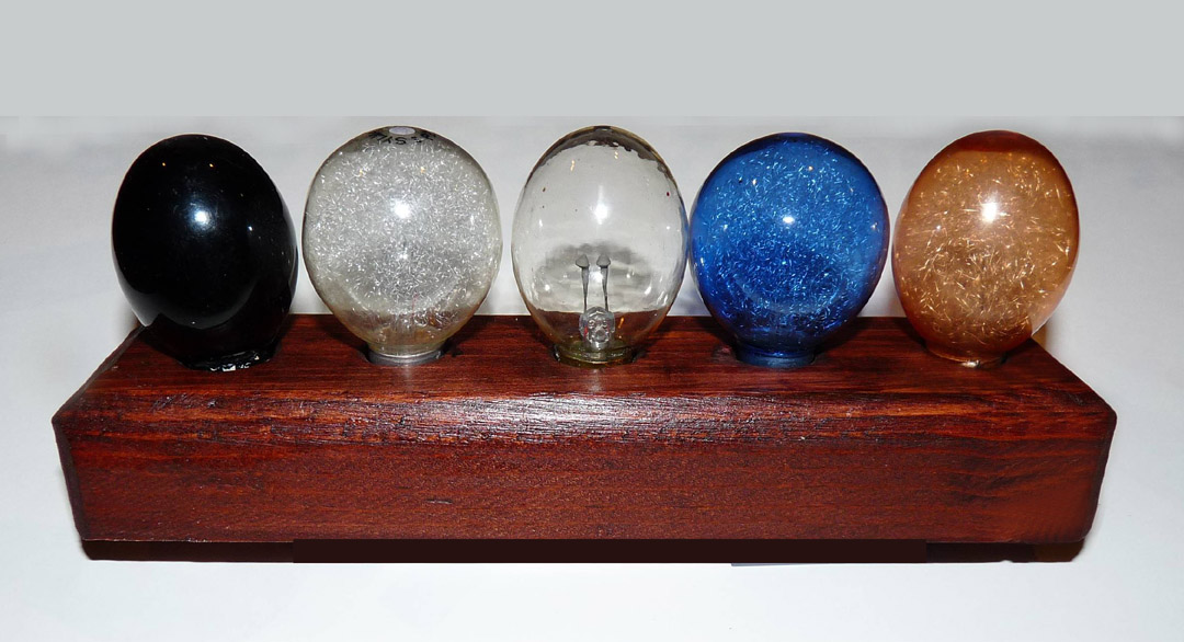

Nope. Not me. Another gear-head working at the warehouse. One of the other guys made this display of the variety shown in flashbulbs we found in that one box.
Cool! Is that one on the left a UV bulb!?? Good for what? Wet plate or tintype or something?
Looks like a #5R (Infrared).
