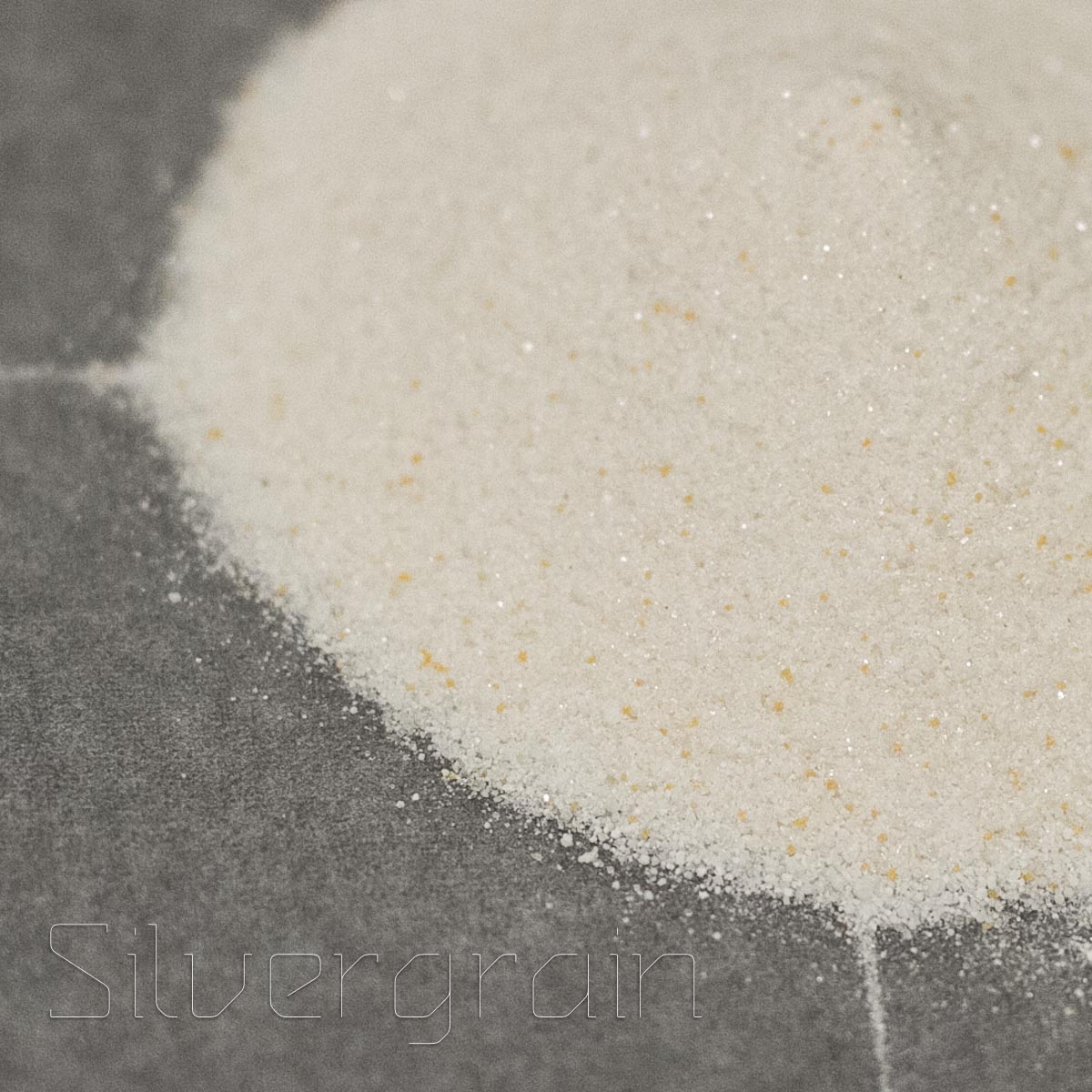

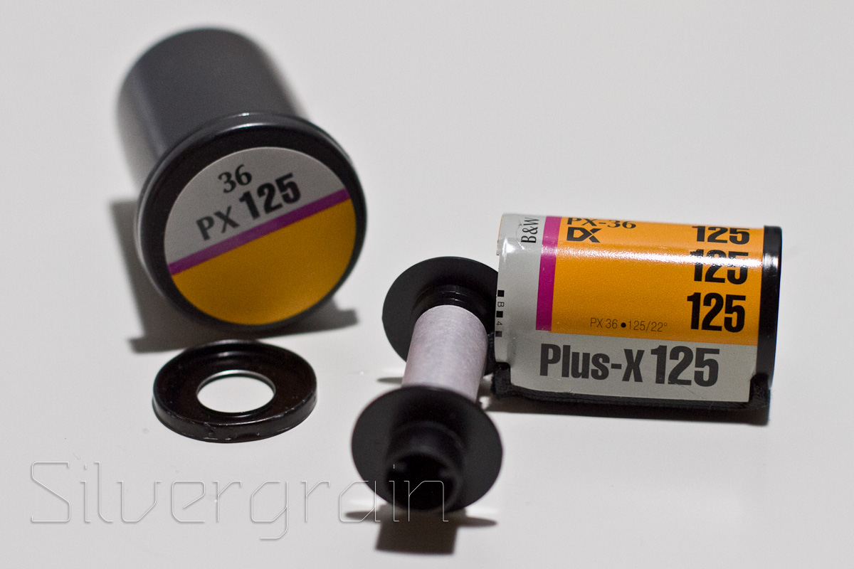

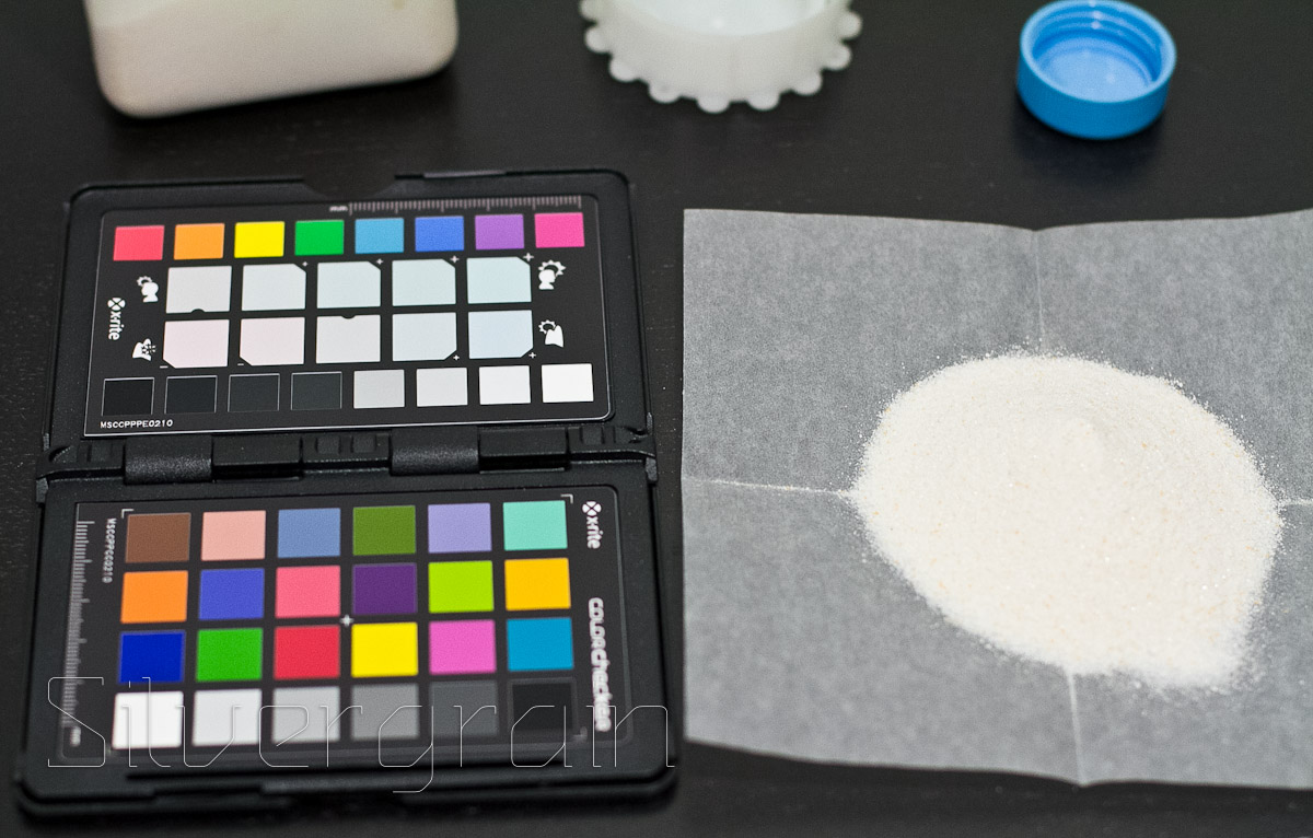

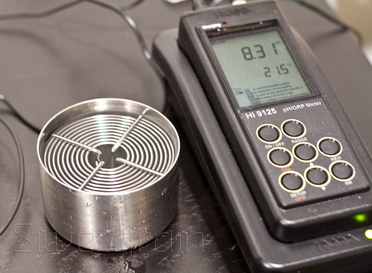

Got a couple of tests done.
Standard usage: take one tablespoon (15ml) of the mixed powder from the jar while stirring and dissolve in 870milliliter of water to make working solution. That is 20g/L. (The actual density of the powder mix is 1.18, so one tablespoon will be 17.4g assuming tablespoon is exactly half fluid ounce by volume.) If you are developing one 35mm film, that's one teaspoon of powder in 290ml of water. You can minimize the wastage by using a cheap digital balance. If you are doing push processing, 30g/L works better. If you are developing Acros or TMX, 15g/L gives more reasonable development time. The powder dissolved while I was loading the film.
The powder mix is slightly yellowish. This is because of the developer stabilizing agent. Dimezone S is the orange granules. Several portions I took from the jar had exact same pH, plus/minus 0.05. Metering by measuring spoons has been pretty consistent, as well.
Attached are the closeup of the powder mix (closeup, intentionally decreased exposure and boosted contrast to show the texture), another with Macbeth chart for color and reflectance reference. I just took the powder from the jar like usual, it did not come straight out of a mixer, but looks just like that. Then two sample images, exposed on Plus-X from 1990s exposed at EI 125 and developed in this soup, 5g in 250ml water, developed in stainless tank for 5.5 min at 22C. The film was exposed with a Russian toy camera, with a fixed focus lens, so the image isn't really Mamiya-sharp. But you get the tonality and feel. The developed negative scanned very well - fine grain, moderate accutance boost, lots of shadow details, and good highlight contrast.
