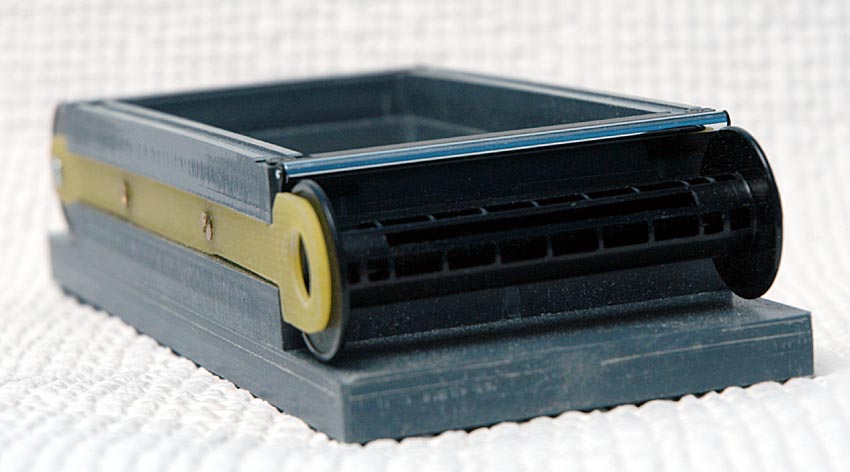

Steve Smith
May 3, 2006
9,110
Ryde, Isle o
Hi Steve, yes, I know your camera for ages now. I read the step millions of times.... :smile: Do you have any interest to make an other 6x12 or 6x18 frame for me? :D
The film holder/film gate shown here: image297.jpg is the second (or possibly third) version I made. I still have the first version which uses some parts from an old folding camera to hold the film, rather than the FR4 springs I subsequently used.
You are welcome to that if it is of any use to you. I can't post a picture of the actual item until tomorrow as it's at work - and I'm not!
It's also worth looking at the Holga 6x12 pinhole camera as a cheap donor for a 6x12 back.
Steve.
