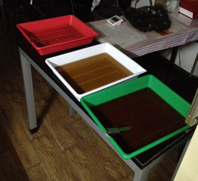

In last weekend l enlarged color paint and my friend help me. We used old technology to developed paper because he havn‘t developing tank, and finally the incredible success, although l only had two pictures of the best. Shortly my friend told to me used dish isn't a good idea, his darkroom has very strong smell.
It can be done in trays but you need very good ventilation that pulls the fumes from the trays away from you (not past you) and to the outside.
