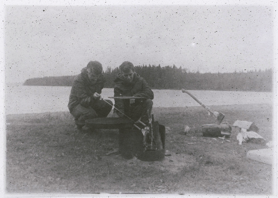

I just wanted to post back to let y'all know I've not given up! I'm still waiting on some items that I've ordered to arrive (magnetic stir bar, filter, monoject syringes), but I was getting antsy and I couldn't wait. So I made PE's basic AgCl emulsion and coated it on some strathmore smooth and some cheap cardstock from Michaels. I really enjoyed the process, and appreciate the support of all you here, particularly PE for his wonderful book and dvd.
I had quite a lot of large black specks (pepper grain?) that I imagine formed because of my woefully inadequate manual stirring as well as uneven/rapid addition with a large tipped medicine syringe. I suspect I'll be able to do better once the stir bar and syringes arrive.
Thanks.
