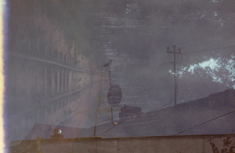

I have this kit. Tried it with expired Sensia 100 and was impressed with my inability to blow out highlights - even with multiple exposure shots.
These are my first experiments developing color, first time developing E-6 film with no real temperature control but a 20l bucket - managed to underdevelop a tad, but got results, so take this into account: https://www.flickr.com/search/?user_id=108634366@N07&tags=DynamicChrome
Other thing I observed - a loss of sharpness. Is this a property of this kit or a development fluke - that I don't know.
Abandoned train by Ivo Stunga, on Flickr

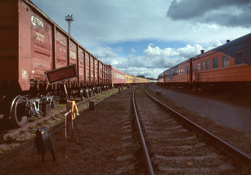

This is what impressed me so much:
2 shots that include skies + a shot of forested railroad track in a shade. Didn't blow out. Have both details in shadows and highlights:
That latitude by Ivo Stunga, on Flickr
Would gladly try again, but current slide film pricing is the cockblocker - can have 3 quality BW slide films for the price of one E6 film and winters over here are... Lets call them a blandscape. Will try again when the spring brings back some colors to the land, though :smile:
In general as you reduce contrast the appearance of sharpness drops. This also happens (quite strongly) with e.g. pulling color negative film. It says very little about the degree of detail that's being recorded, but it just looks more...fuzzy.

Back in the day, I might recommend the older, pre-E6 Agfa slide films for those who were seeking a less contrasty and more pastel pallete than the usual Kodak or Fuji offerings.
This shot owes its lower contrast appearance to the character of the light - diffused and enveloping - but something similar might be obtained in harsher light with the Cinestill product:
