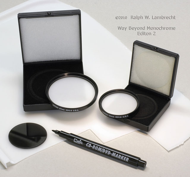

I've tried this paper. Unless you are interested in some special effects, you need to pre-expose (fog) the paper first. I suggest an in-camera Zone II or III pre-exposure with a diffuse filter, such as the DIY filter in the attachment. Ilford suggests a pre-exposure in the darkroom prior to loading the paper into the camera. I found that to be cumbersome.
