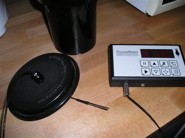

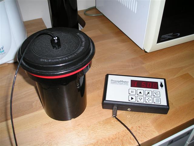

Comments and suggestions on the above spec are welcome - I can't promise any changes will be acted upon but we will consider all of them. In particular, the sensor is currently housed in a stainless steel tube 3mm x 50mm with 1m of cable attached. It fits through the "twizzle stick" of a Paterson dev tank allowing agitation by twisting the stick, or if as I do you prefer inversion agitation, you can fit a suitable cable gland to the tank lid which allows the probe to be placed in the fluid but prevents leakage when the tank is inverted. This should work for other tanks too. See attached pics. It's not too late to change the size of the sensor housing or cable length so if you have any observations please let me know asap!
