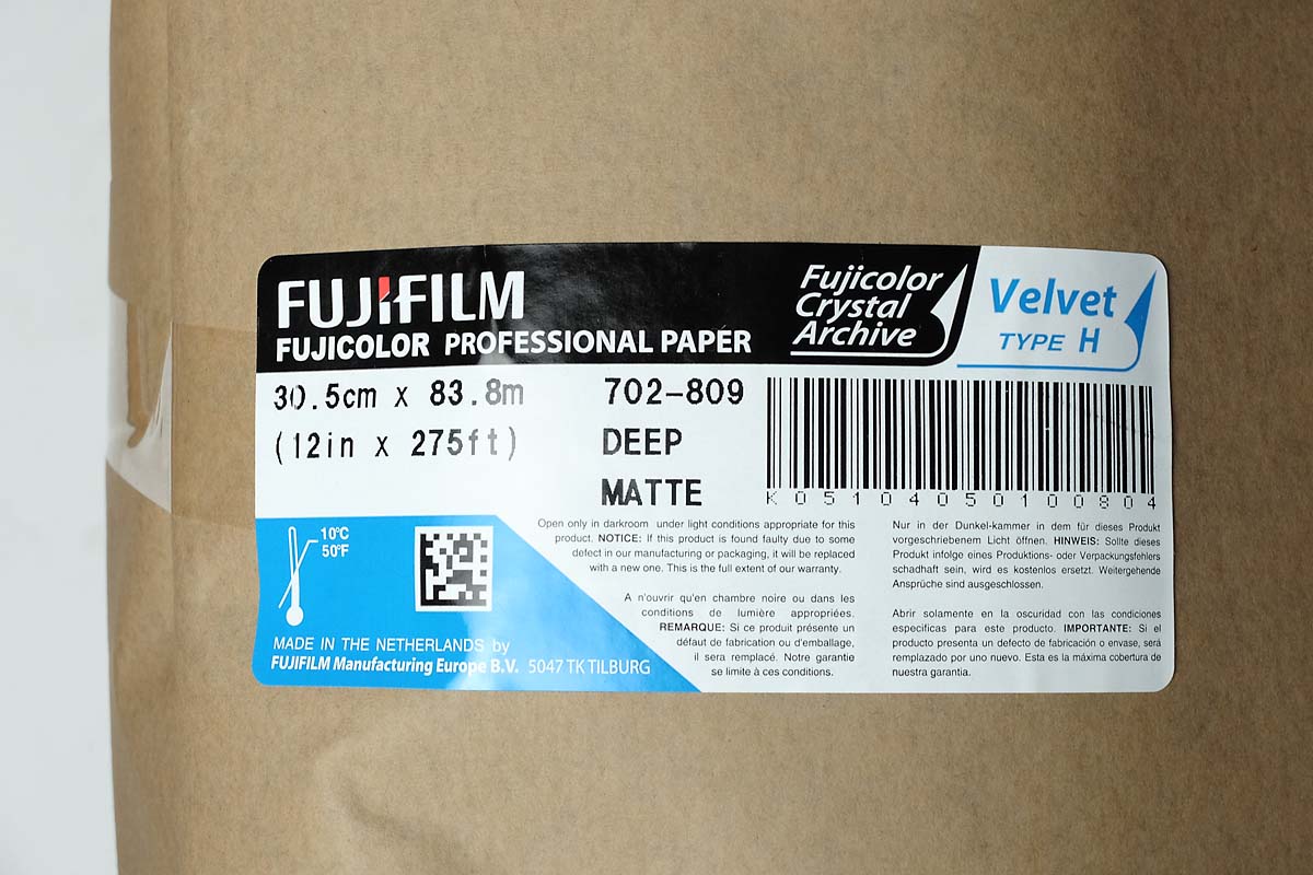

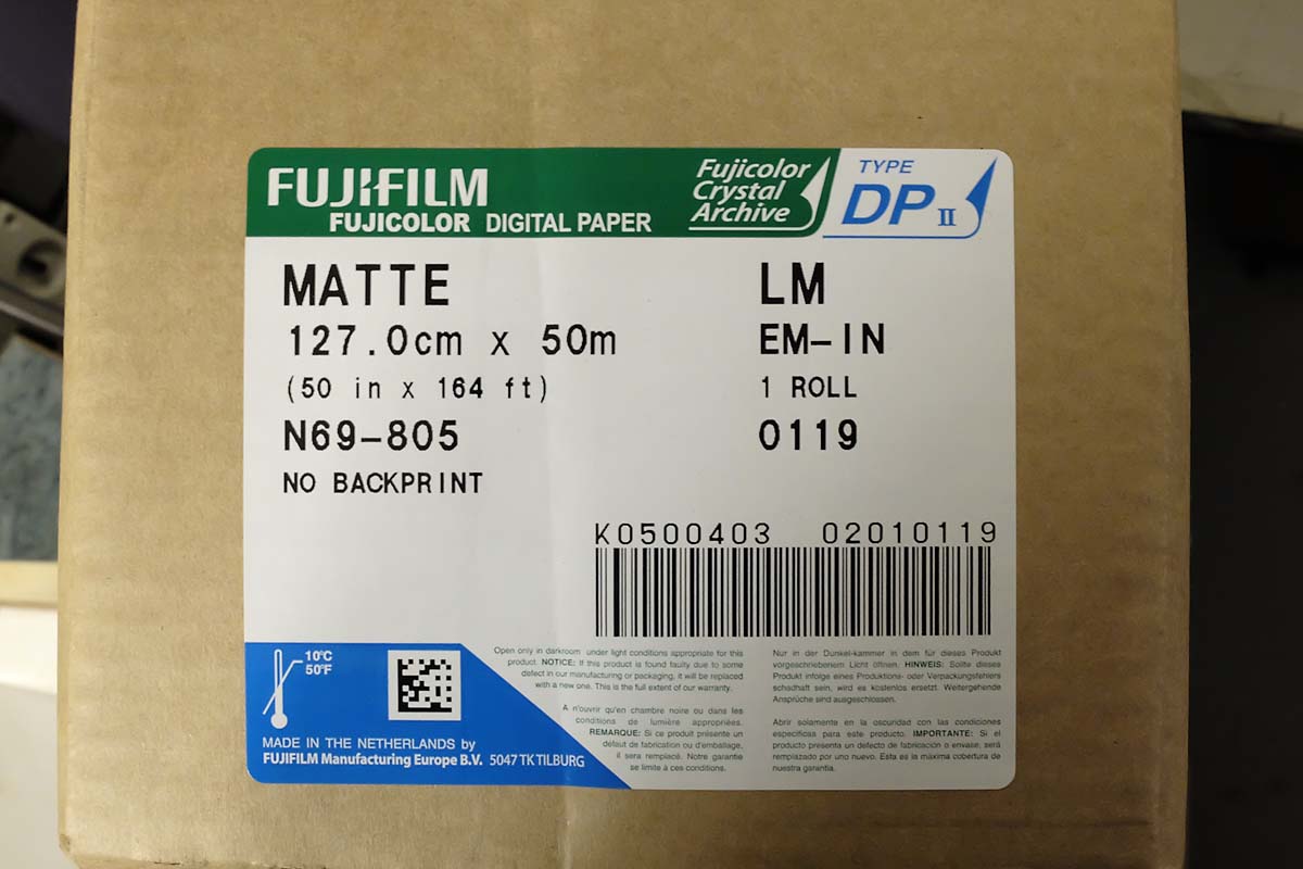

As far as we know, the emulsion is different to DPII - Type H refers to the emulsion type, and it does seem to perform differently to the DPII.
They describe the surface as "Deep Matte" The weight of the paper pretty much, if not exactly the same, as DPII. The 12" rolls have 83.8m which is the same as DPII - if the weight is different the length increases or decreases on the rolls destined for magazine use so that the diameter remains the maximum that can be accommodated.
I've attached a photo of the label, and also a typical DPII label too.
