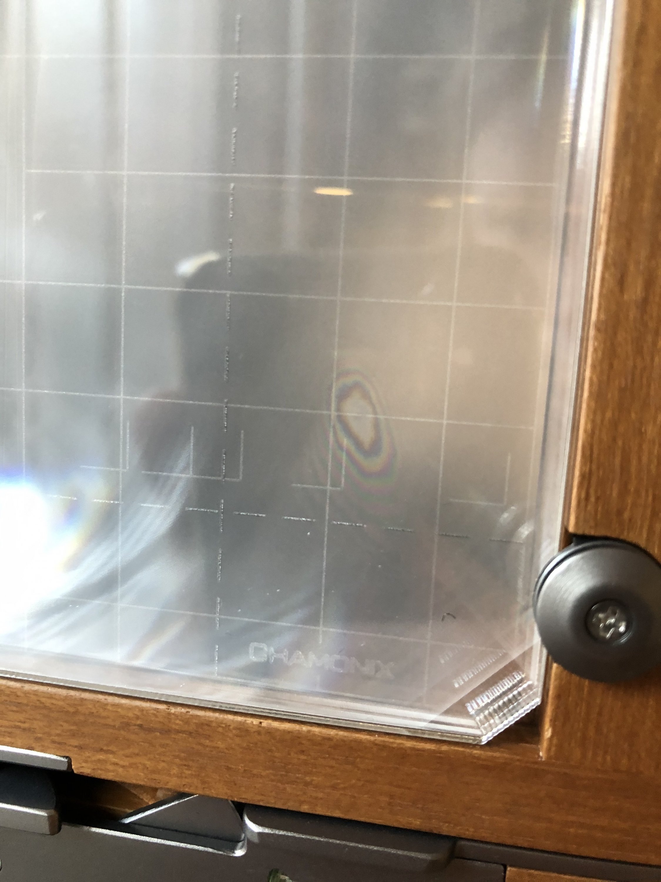

I'm pretty new to this, actually just got my first LF today. Looking at the ground glass i noticed this "dot", "spot". Can someone explain what it is?
I got the camera brand new and it was like this out the box. I suspect it is because of the tensions between the fresnel and the glass but im not sure. Looks like it is not supposed to be there.
Sorry for asking what might be a stupid question, but i dont know anywhere else to ask.

They are called "Newton's Rings" and are caused by very close contact between the smooth back sides of the GG and the fresnel.
The rings should be invisible when you are using the camera.
Loosening the screws holding the fresnel in place should remove them. If not then a few paper shims between the GG and the fresnel should space the two apart.
Contact Hugo Zhang via email at hugoz_2000 at yahoo com if that doesn't work. He's the North American rep for Chamonix.
Thanks alot for the fast replies!
Will try and loosening the screw. Then contact Hugo if it dosen't work.

Why? Why should he not loosen the screws a tiny bit and see if the Newton rings change?
For a brand new camera, I think I'd like to receive that advice from the manufacturer's representative first before I made that adjustment.

My 4x5 Chamonix had the same Newton Rings (albeit in a different place on the GG) when I acquired the camera. I just ignored them since they essentially disappeared when I was actually using the camera. For the heck of it, I just checked the back of my Chamonix and they are still there... I just haven't noticed their presence in years since they had zero effect when I was using the camera.
