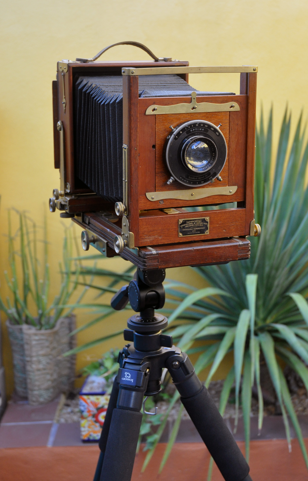

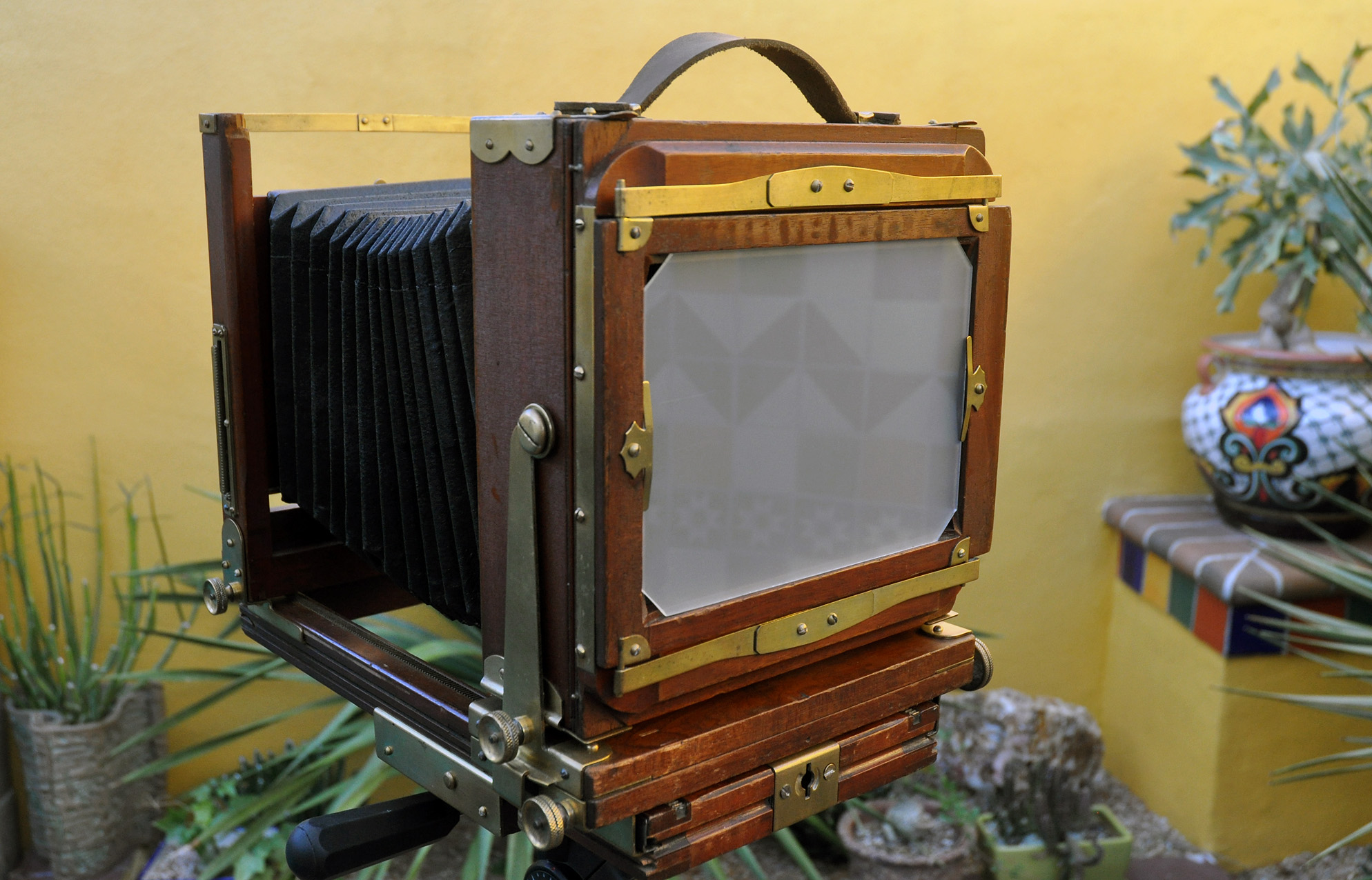

I have a very similar 5x7 Eastman View #2. Been shooting a lot of film and recently bought some of J. Lane's dry plates to try out. If you have plate holders, you're already set to go. Just the same as shooting slow film. These old wooden cameras are a blast to use and it's nice to know you're using equipment that's been around a century or more. Have fun!
