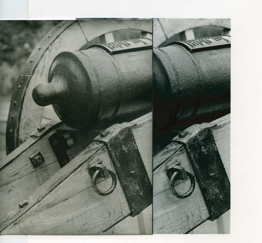

Here is a scan of two prints. The original, in 35mm was shot on Kodak TMY and printed on Ilford MGIV FB. The other is an enlarged negative using a reversal process on Arista APHS. The enlarged neg was being made for cyanotype, this negative is a reject, but looked dense enough to work with my paper emulsion. It's a first try, not tooooooooo bad. I think a quick dip in some bleach would liven it up.
Ilford is on the right, of course, and mine on the left.

You guys are right. A bottle of Ethanol, labeled Denatured had the label "contains Iso Propyl Alcohol" and my mind did a glitch.
Just make sure that any denatured Ethanol does not cloud up when added to water. This indicates the possible presence of a denaturant that is incompatible with emulsion making and coating.
IPA has no hardening effects but it does act mildly, as I said above, as an antifoamant and a surfactant. Beware of those brands with oils and perfumes. They can cause coating problems.
Tim;
Your results are very fine. How do the exposures compare for time and lens opening?
PE
