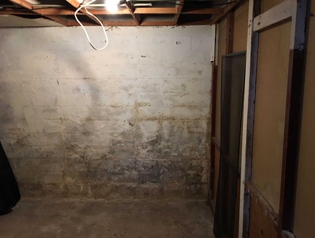

Hi! I've been a long-time reader but first-time poster who's trying to make the leap to a budget darkroom space. I bought a bunch of darkroom equipment (enlargers, trays, lights, timers, etc.) very inexpensively so I'm good there. I identified a spot in my basement but I don't have a lot of experience building or framing. I was hoping I could maybe get some advice. the space is about 8-foot by 5-6 foot. I'll attach a picture of the space.
1. I was thinking I could just get some plastic sheeting, build a frame with 2x4's and deck screws and staple it to the frame, put a few tables in there (one for dry side, one for wet maybe with the trays sitting in a bigger tray of some kind) stick a 4inch dryer vent fan on one end and run a tube out the other. Is this a good idea? I thought I could just hang some sheeting or curtains but light gets in the top. I purchased some of the stuff to do this but then had second thoughts hence the post.

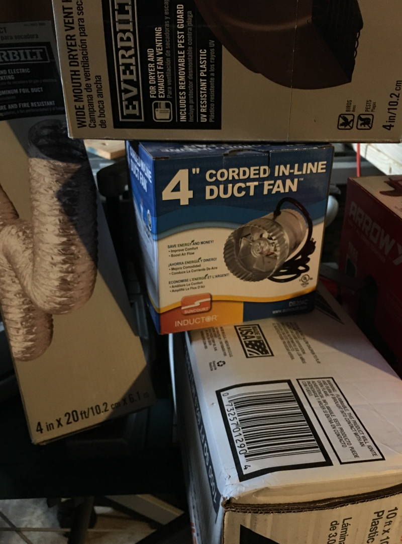

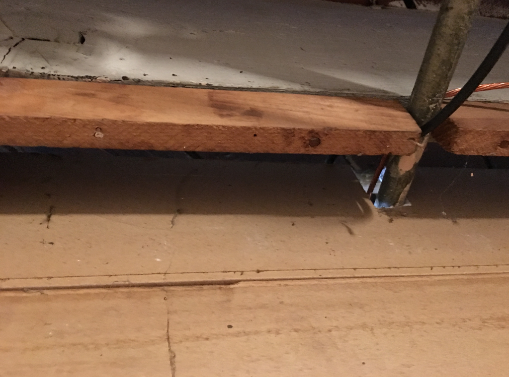

Here's what I bought: DarkRoomFan+Sheeting.jpg ... and here's the light leak I was talking about: BasementLightLeaks.jpg
2. If I do that do I run into issues with code, etc? I don't want to do anything I shouldn't.
3. Should I be more ambitious? I'm enthusiastic enough I'd spend one or two thousand dollars but don't have much more.

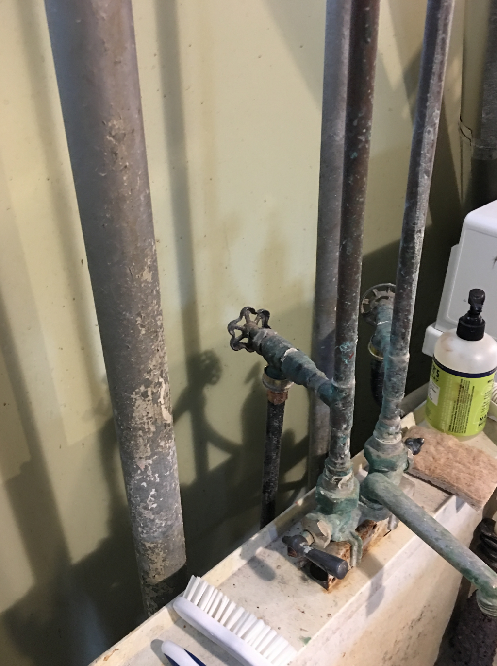

4. Across the sheet rock wall on the other side is the basement sink-- would it be really expensive to somehow connect to it? Worst case I'll just walk around to wash prints.
Here's the sink plumbing: Laundry Plumbing 1.jpg

You must not overlook to allow the same flux of air through your basement as the ventilator sucks-in.

I wouldn't bother with the plumbing. Hundreds if not thousands of folks have managed to walk a few feet to reach
running water I did that for years. It looks like the faucet has standard hose fittings. You could run a hose(!) from there to the darkroom. That invites
leaks and what do you do for a drain? The light around the pipe could be blocked with expanding foam or packing the gap with fiberglass insulation or even
stapling light proof plastic/fabric/? from the joist to the wall under the pipe. You have much more freedom than someone that rents.

Thanks for all the great advice / replies... I'm seeing a short term and a long term maybe? I'd like to be able to something near term-- maybe just get a couple tables, hang up some sheeting without bothering to frame, open a window in the next room to allow airflow, block the light leaks with foam or more plastic sheeting and forget plumbing... then read the books for longer term advice on how to build it out further?

You have everything you "need" to get started.?.......so do that, and it will become obvious What you need and Where you need it.
You will have a better darkroom That Way, than if you try to build one from a Standing Start, so to speak.

My suggestion, do the minimum! Start printing and then worry about the perfect darkroom later.
I place trays on washer and dryer, have the utility sink a few feet away for print washing. I do not worry about the light leaks, I work at night. If the light is not there then you need not worry about the light sneaking in. Black builders plastic makes the neighbor go away. Do not wait the rest of your life preparing to print, start printing NOW!
