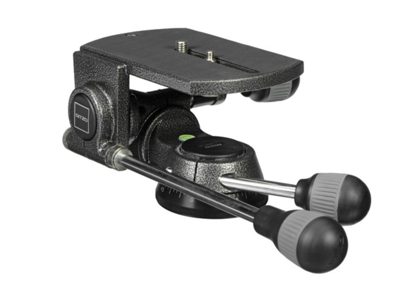

Last night I was looking at one of these Gitzo G-1570M Rationnelle Magnesium 3-Way Pan/Tilt Head HERE But for the love of me I can't figure out how you would get it on and off the tripod without a quick plate..........does it mean you have to leave it on the camera all the time.
All the reviews are from people with LF cameras 8x10 especially and they swear by it.........I guess I am missing something:wondering::wondering::wondering:

Hello Mike thanks for the info on the Manfrotto head, I like the idea that it comes with its own quick release but on the photo the quick release plate looks kind of small for a 8x10 ??

Ive had loads of Tripods with various ball heads, RRS Gitzo Manfrotto etc etc. All of my tripod heads have had a Acra Swiss quick release type head so that you would have a base plate on the bottom of the camera and that snaps into the quick release of the ball head.........simple
If you look at the picture of the Gitzo, there is no quick release and from what I can see with the head already on the tripod it would be a nightmare trying to #1 line up the holes on the base of the camera with the 3/8" stud, and #2 once you do line it up, then how do you tighten that up, on some heads they have big enough locking devices that you can get plenty of leverage to do this by using your finger and thumb, on others you need to use some sort of a allen wrench.
Sorry if all that sounds long winded but looking at the picture below, it would be hard enough with a DSLR let alone a 8x10 camera .................hopefully I'm just missing something here :smile: :smile:

I think you will find that many large format photographers don't use qr for 8x10 and prefer to attach directly to the tripod head. I use QR for 4x5 but not 8x10.
If you google that head, you will find a video that shows the underside of the top plate and that shld explain all you need to know about how to attach a camera.

Fantastic, I will get it..........Yes I can now see the size of it (its frigging big) and I like that kind of knob locking device.
Thanks again........like they say a picture is worth a thousand words, a video is worth more :smile: :smile:

The Gitzo head is very nice. It will do a great job.
The included quick release plate for the Manfrotto 3039 (229) is rather small for an 8x10 in my opinion. That's why I replaced it with the larger 4"x4" quick release plate. Unfortunately, those larger plates are no longer made although you can still find them used.

Thanks Mike.
I've decided on the Gitzo above after seeing the video. I have asked my supplier in KL to get me one :smile:
Loosen that front handle to tilt the head to an angle. This will allow you room to get your fingers in there to tighten the tripod screw. It also makes it easy to see to line up the camera threads to the head screw. After your camera is attached then tilt the head back and level using a separate level like a cheap torpedo level.
I attach my Wehman 8x10 camera to my Ries head all the time doing this. It's fast and easy.

Exactly as Alan says.
The Gitzo tripod screw is in two parts, you screw it in finger tight, then use the finger nut surrounding it to tighten the connection. Very secure. I tilt the camera forward slightly so I can see to match up the hole and screw. Another great feature is the screw at the front of the plate, if you tighten it up against the bottom of the camera you get additional security and anti twist benefits.
Cheers Alan
Cheers mate.....hopefully my supplier in KL can get me one :smile:
