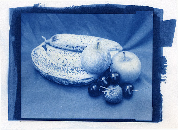

philldresser
Feb 4, 2003
1,413
Norwich, UK
Lucas
Attached is the cyanotype for reference. Density is definitely not 3.0.
Ole. Do you think it would be worth trying to redve in Pyrocat-HD. Is this staining enough?
Phill

The salt I've used was sold as "kosher salt" -- it's listed as containing a tiny quantity of "yellow prussiate of potash" aka potassium ferrOcyanide -- which is not the same as ferrIcyanide used in photographic bleaches. I'm still working on getting enough contrast, however, and I think much of that has to be done on the negative side.

philldresser said:
Ole. Do you think it would be worth trying to redev in Pyrocat-HD. Is this staining enough?
I think it should be, although I haven't tried that myself. When I did that, I had no pre-made Pyrocat-HD left. So I just took the basic raw mateials to make an ultra-staining "developer". The negative was cr*p as it was (and a backup besides), but the increased contrast made it just right for POP and salt prints.
Is this a guarentee that I can get winners from all my cr*p negatives? :wink:
I mixed up a batch last night so will give the pyrocat a try and see what happens.
