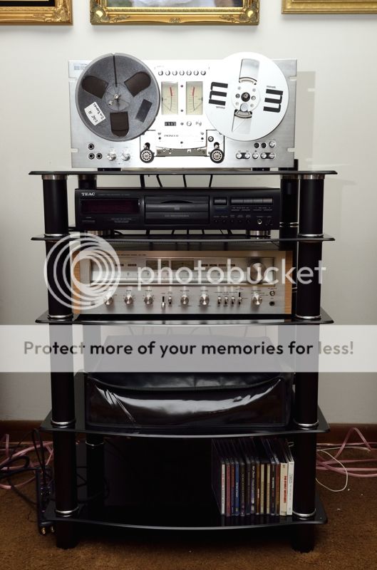

Yep-I can identify...stereo equipment as well. I can get Nakamichi tape decks still and Marantz receivers but, I can't get Agfapan 400 anymore.
I know this has little to do with the topic but I like my old stereo equipment. A Pioneer RT-707 reel to reel tape deck atop and below a Pioneer receiver.

But can you get tape? Besides the old Quantegy stocks and ATR
