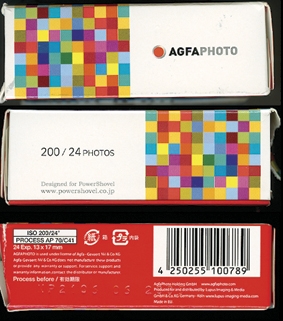

I had a new product come into the store today a man who shot on the following material
AGFAPHOTO 200iso color negative 110 film dated 2009. this material was brand spanking new and a damn nice film to print from. the colour was rich the grain was fine and comparing it to other 110 film types I have worked with it would be my colour film of preference for the 110 format..
I have scanned the box for all to see. There is a very interesting thing printed on the box as well which reads DESIGNED FOR POWERSHOVEL and then a very small text stating that Agfa-gevaert NV& co KG does not manufacture these products or provide any warranty or support.
http://www.powershovel.co.jp/en/works8.html
Anyhow there you go hehehehe....

well there it is....

Stephen,
that remark on that box would not seem that strange with my thread
in mind.
Not that long ago there was a film called “Agfa Vista 200”
Now there is a film called “AgfaPhoto Vista 200” marketed by a company, Lupus, seemingly related to AgfaPhoto. This film is given a datasheet identical to that of the Agfa Vista…
Your film is packaged in a different design but also called “AgfaPhoto Vista 200”. Thus most probably it is original Agfa/AgfaPhoto material. However Agfa did not manufacture this film as 110 type, which could mean that an Agfa/AgfaPhoto masterroll has been used for making this type.
But, to make things more complicated there is a reference on the net to an announcement by Lupus that they have made films for them by a company other than AgfaPhoto, which is out of manufacturing anyway.
With that outcome of that legal case anything will be possible...

Lupus Imaging is one of the companies that licensend the brand "Agfaphoto" after the demise of the original AgfaPhoto (a very short-lived split-off from the original Agfa, which should handle "consumer imaging" business).
Lupus is not allowed to use "Agfa", because this brand still belongs to Agfa-Gevaert in Belgium; a company, that is still alive and kickin', and which produces microfilm and aerial film, among a lot of other great products.
At the moment, Lupus is selling mostly original Agfa material, which was made in the last production runs in 2006. In the future, they can (and, I guess, they will) sell any type of 3rd party film as "AgfaPhoto". Just as other companies already sell junk digicams, junk memory cards, and junk batterys under the well regarded name of "AgfaPhoto".
