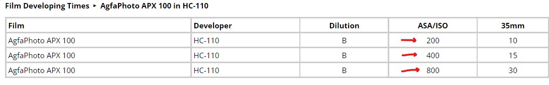

Does anybody know the developing time of the Agfa APX 100@100 and APX 400@400 with HC110 dilution B?
I´ve tried massivedevchart and i don´t find it. Also tried searching for the pdf´s of agfa but they don´t include hc110.
Thanks

arturo_rs
arturo_rs
May 4, 2022
76
Spain
I am puzzled !
The data of the AgfaPhoto APX in HC 110 are on the massivedevchart.
But those of the Agfa APX are not. That is why I assumed the OP actually meant what he wrote, namely inquiring on the 17 years old Agfa made APX films.
But....APX 100 pushed, not @100.
With APX 400, is true but i´ve search and i found 6 minutes vs. 8 minutes (massivedevchart). Any big diference between 6 and 8 when developing? I mean, the results might be the same?
Thanks

I see. I just saw the chart, but did not look for details, as I did not expect such chart for a standard developer to contain only push-processing results. Weird.
