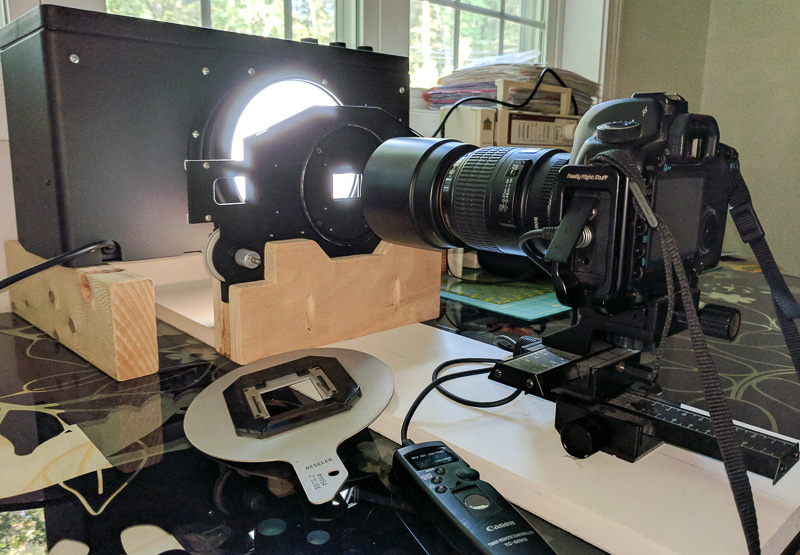

I have built my own rig: two cheap macro rails (from some Chinese manufacturer on Amazon) are mounted on a board on top of and orthogonal to each other. The camera clamps onto that and thus can be moved left to right and forward/backward (for focusing). The film strip goes into a Beseler Negatrans carrier which is also mounted on the same board at an appropriate distance to the camera. That way I can easily move through all 6 frames in a 35mm film strip just by turning a knob on the Negatrans.
With this setup all images that I capture can be cropped at once in Lightroom, they all need exactly the same crop.
Can you post picture and link to these things? My setup is a little more basic.
The negative carrier is free, I have to slide it into frame while looking into live view. Some sort of rail system would be a game changer.
Here it is:
I'm using parts of a Beseler 45 enlarger. The color head is my light source and the slide carrier and Negatrans carrier hold mounted slides or strips of negatives. Just google for "Beseler Negatrans" and you find plenty of information. It comes in different versions. You feed in the strip of negatives from the side and use the little knob to go from one frame to the next.
The wooden base in the middle can accept either film carrier. I got a bit lazy and didn't design in a mechanism to move either the camera or the film holder up and down. But that hasn't really been a problem yet.
With the upper macro rail I move the camera left/right to adjust to the position of the film carrier. And with the lower macro rail I'm focusing.

Here it is:
So in looking at my setup all I need is a Beseler Negatrans clamped down on my lightpad?
Yes, that should do it. With some effort you could also build some contraption that re-uses your film holder: if you can slide that left - right and have some mask (revealing the current frame) at a fixed position in front of it, then the end effect would be pretty similar.
