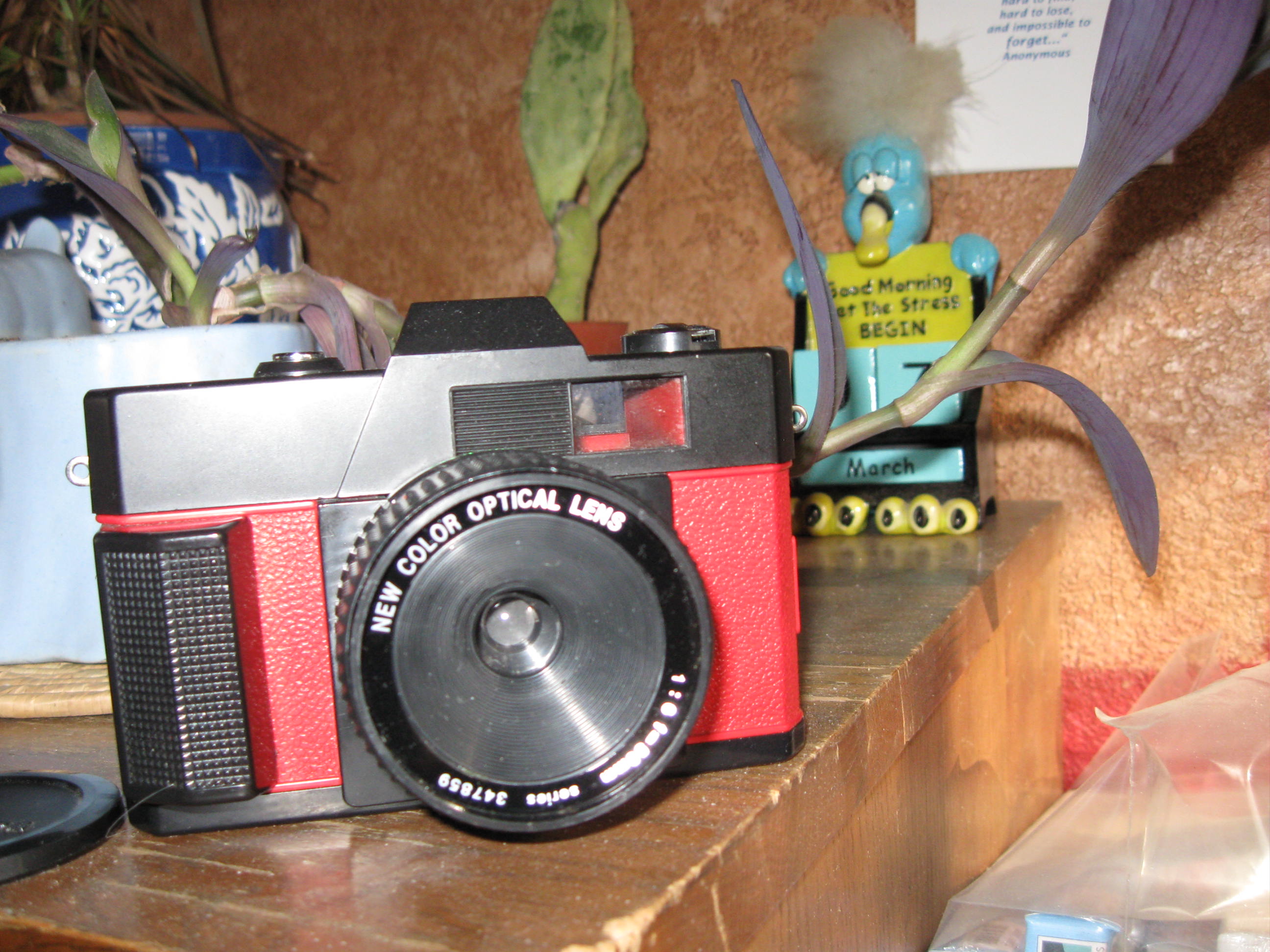

This is/was my toy camera. was able to run one roll through. rewind, then pulled up on the crank and it snapped out of the plastic. I did manage to pull up the film crank housing which is what I should of done instead of pulling the crank. It has the sun/clouds,scene icons and is a 50mm "new color optical lens" and apertures that coincided with the icons when twisting the ring. Anyway, don't get caught up in it..just enjoy.
