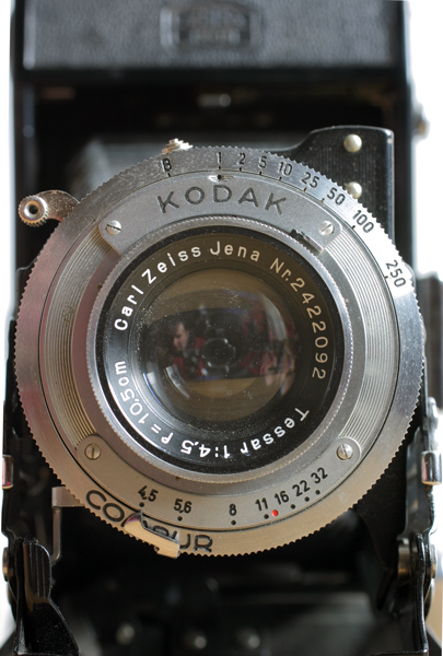

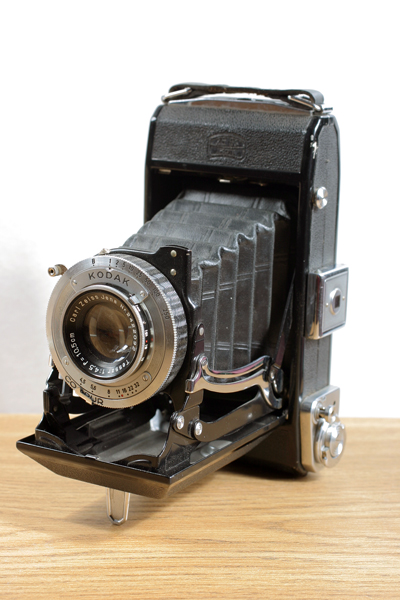

Hi all,
Just bought a Nettar 516/2.
It's nice and works perfectly, but I am not sure it's a "true" Zeiss Ikon with its Kodak pieces.
What do you think about its front face ?
I haven't seen a 6X9 Kodak camera with this face but I don't know a website with many old Kodak cameras...
Regards,
André

It might be worth mentioning that all 3 , the 516, 516/2 and 516/16 are mentioned in a Dutch Zeiss Ikon brochure from 1940 on page 7.
The brochure is called "Schep vreugde in het leven met een camera van Zeiss Ikon" which translates to "Enjoy life with a camera of Zeiss Ikon".
All 3 models are described as an upgrade to the 515, 515/2 or 515/16 with a Double Exposure Prevention system. Also the lenses are in all cases Novar's instead of Nettar's.
I added these models to the Nettar page of Camera-Wiki :
http://camera-wiki.org/wiki/Nettar
If somebody knows a 516, 516/2 or 516/16 equiped with a Tessar lens please let me know as the brochure is not very clear if this was an option (my feeling says yes) and I did not find online any image of such camera yet.
