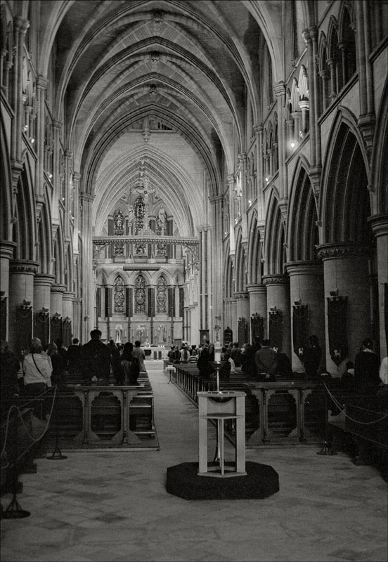

I meter for the area where I want detail in the shadows and then close down 2 stops, I find that with developers like Rodinal at 1:50 that if I avoid vigourous agitation say one or two slow/rolling inversions per min I get great shadow/highlight.
This is Neopan 400 in a very dark cathedral, with bright spot-lit pillars deved in Rodinal 1:50
Shadow and highlight preservation is one of the reasons to use Neopan IMHO
