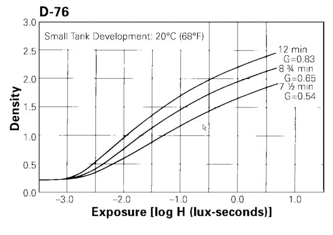

Fijifilm's sensitometric graphs show that Neopan1600 is 2/3 of a stop faster than Neopan400. I will try to extract the graphs from pdf files and upload them.

Attached screen shots from Fujifilm's pdfs. Have just updated from Windows XP to Windows 7 and my handy utilities no longer work. The screen shots are the best I can do. These are just for D-76. I could put the pdf files somewhere for download. Where would be a good place?
