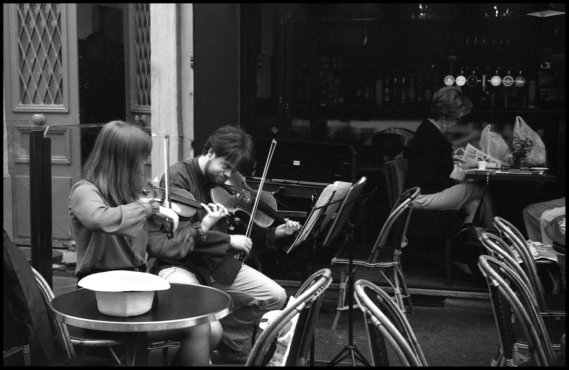

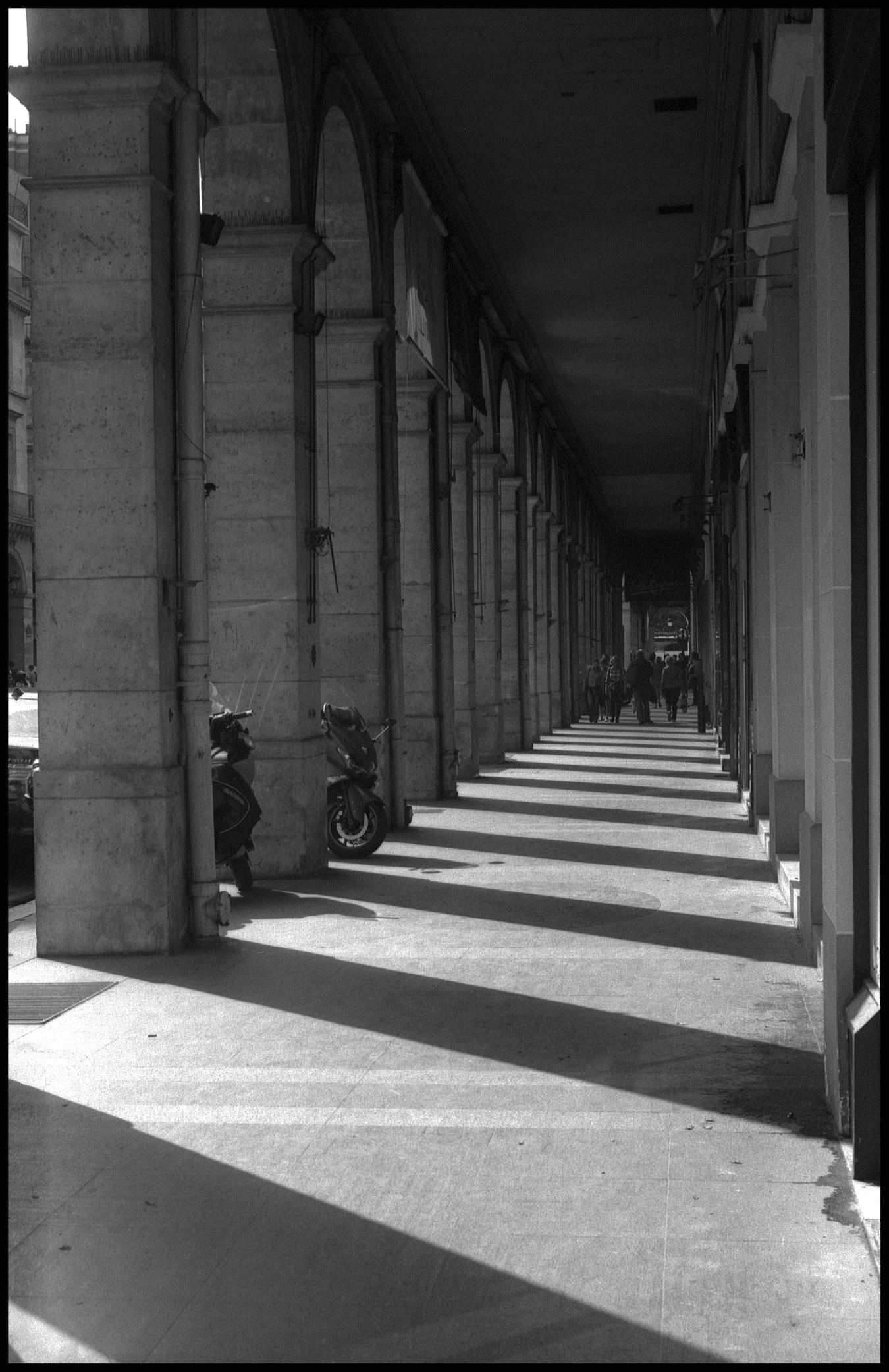

OK, so it's high speed, but the OP is willing to live with a reduced ASA. Older films can work just fine -- here are two on Agfa SuperPan 200 expiration July 1984 as I mentioned above, shot in a Leica III with a Topcor LTM lens, developed in ID-11 just six months ago. I fully understand that recently manufactured film does not present some of the difficulties you may/may encounter with older film, but if the investment is minimal why not give it a try if it turns you one? I read some of the other comments here as being a bit dogmatic -- you shouldn't do it, as if doing so is in violation of some inviolable rule. Sometimes you've got to let your backbone slip, as long as you understand the financial or photographic risks you're running.
