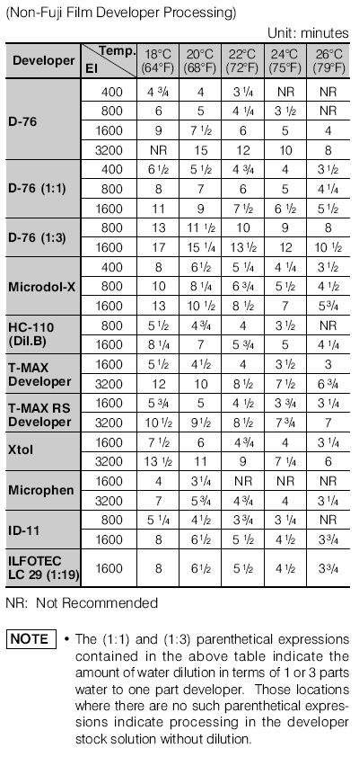

According to Fujifilm's pdf some of the dev times are short. See attached.
